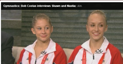

sorry about the vagueness. I thought it was on only one station and who out of 6 billion hadn't seen Bob Costas w/ Phelps? LOL
Here is a screen grab.
Jeff

Yup that is two mics a main and a spare, cant tell from the photo what the model is. In the 80's we used to use sony ecm77b's but sine I mainly work in post now I dont know what the current trend is. They all sound dreadful and even worse on women though and lots of eq is required compared to a desktop mic.
I noticed that the BBC is using headset mics like the countryman.

I guess I am pretty naive here. I too thought since it was studio oriented that they would use booms or overheads. I never realized that they would use a primary and a secondary. Thanks guys.

It's a bit over the top double micing these girls as they where only guests and where sat right next to each other. Maybe they just keep moving the rig between guests and left it doubled up. Makes sense on the presenter but for guests it's overkill really. Even more so if they are hard wired as opposed to radio.
Studio booms went out of fashion when decent lapel mic's arrived o the scene quite a few years back now.
