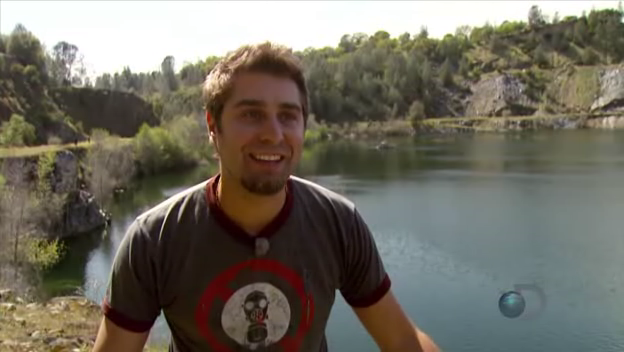

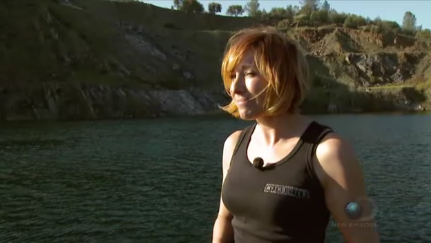

I haven't got a framegrab to hand, but they seem to use- if not Rycotes then something very similar- them on Mythbusters frequently. Pinned up at the neck of a t-shirt they're not very noticeable, especially using the white ones on a white t-shirt, on the blacks on a black t-shirt.
I have a pair, and they really do make an incredible difference, and compared with some Rycote kit, they're not an utterly ludicrous price.

Here's some shots of the presenters of Mythbusters wearing, if not the Rycotes, then something that looks identical to me.
As for what wind they'd protect in, all I can say, not owning an anemometer is that the branches of medium sized trees were swaying a little, and I was getting occasional hits of that typical mic-disturbed-by-wind noise in my own ears. And nothing came through on the recorded sound.
