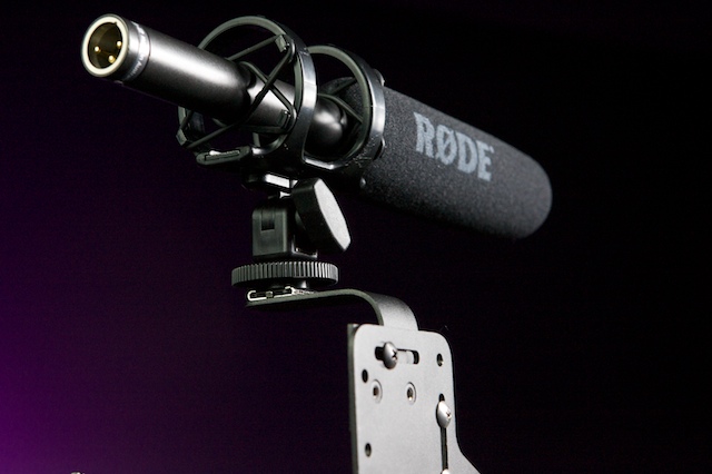

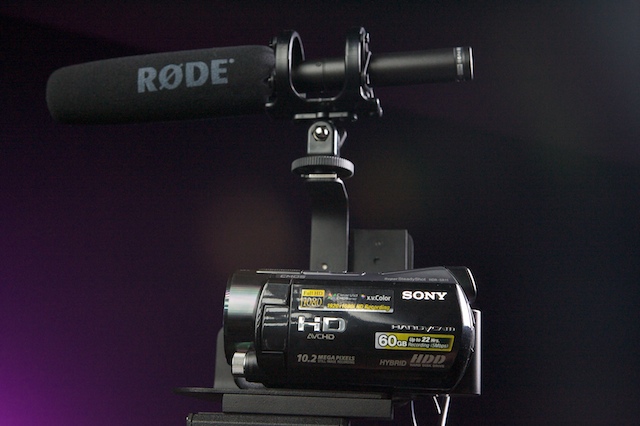

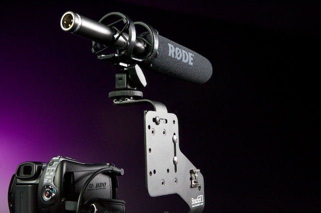

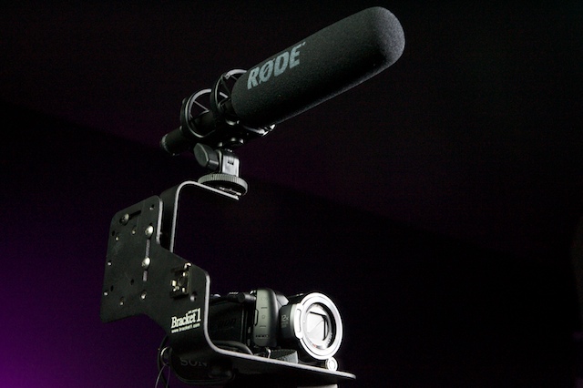

So I went out and bought a Sony HDR series camcorder today to test out. Just for you :)
The accessory shoe is smaller than standard and made for Sony's proprietary gear.
Here is a few photos of the Bracket1 Mini with the over the camera cold shoe mount and RODE SM3 suspension shockmount.
Short shotgun on Sony HDR-SR12?-pi5j6962.jpg   Short shotgun on Sony HDR-SR12?-pi5j6961.jpg
Short shotgun on Sony HDR-SR12?-pi5j6956.jpg   Short shotgun on Sony HDR-SR12?-pi5j6959.jpg
Guy Cochran

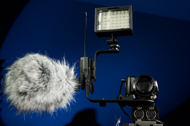

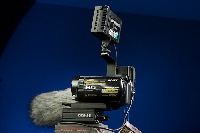

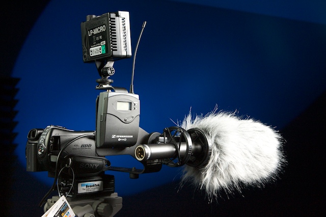

OK. Had to toss in the pics of the Sony HDR-SR all decked out and accessorized.
Ready for a night out on the town :)
- Litepanels LP Micro camera light
- RODE NTG-2 shotgun
- RODE SM3 shockmount
- RODE "Deadcat" windmuff
- BeachTek DXA-2S XLR adapter
- Sennheiser Evolution G2 wireless
- Bracket1 Mini with Over the camera shoe, cold shoe 1 and ew clip
- Matthews M25 tripod
Short shotgun on Sony HDR-SR12?-pi5j6969.jpg   Short shotgun on Sony HDR-SR12?-pi5j6968.jpg

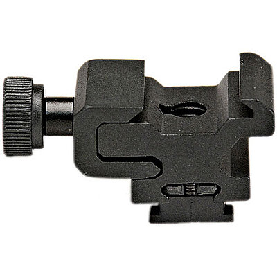

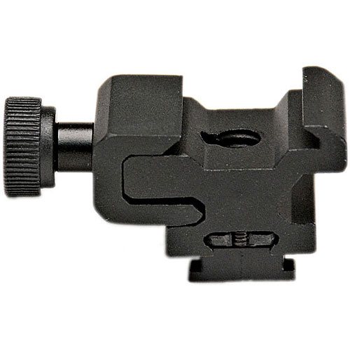

Also, B&H has a little AIS to standard size cold shoe adapter. I was stoked at first, however, the reviews of the $19 product don't seem to be too good. Worth checkin' out though Pearstone | Cold Shoe Adapter for Sony AIS | SSA | B&H Photo

Forgot to mention to the original poster that Adorama has two different style Sony AIS to cold shoe adapters.
AISCUBE Adorama Universal Cold Shoe Adapter for Sony Type AIS (Active Interface Shoe) Hot Shoe
AISFLAT Adorama Universal Cold Shoe Adapter for Sony Type AIS (Active Interface Shoe) Hot Shoe (FLAT TYPE)
The reviews on the B&H item said it was kind of loose, I'm hoping the Adorama adapter is better,but there are no reviews.
