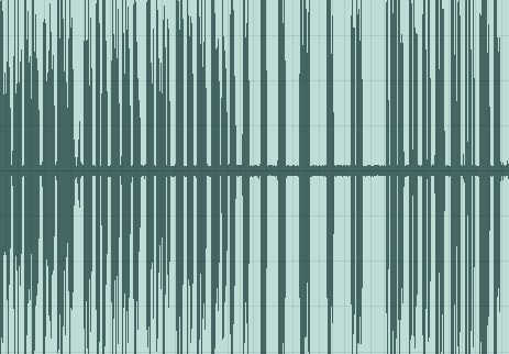

I think from the frequency wave (in STP) this then is fairly evident (if it's the central band running throughout the entire waveform):

David, I notice a couple of points in the posted timeline/waveform where there is ONLY background noise. Try this:
Carefully select just a section of "noise"
In the Process menu select Noise Reduction > Set Noise Print
Select the entire wave form
In the Process menu select Noise Reduction . Reduce Noise and play with the settings until you've eliminated or lowered the 50Hz noise floor.
WARNING: Overly aggressive use of the Noise Reduce function MAY cause mosquito style artifacting which in some cases is WORSE than the 50Hz hum.

Hi Shaun, I just happened to be playing with Noise Reduction in Soundtrack Pro...and it's working quite remarkably. Not sure yet at what level the db noise reduction should be set at (defaults at -60db which is just about right...a slight buzz is left but it's almost perfect.). I haven't tried the Set Noise Print route yet, rather selected the whole waveform (or parts when first testing) then clicked on apply. There seems to be a slight, almost negligible degradation of the vocal performance...although I'm almost convincing myself there is one rather than it being obvious.
I guess I can then send this back to Logic and apply compression (double tracked), EQ if required and the odd effect (again if required).
Still like to work out the method for inverting the phase mind. The DC offset, Power line hum analysis in STP didn't seem to do anything, rather strangely??
I'll post a before and after quick sample of the Noise reduction and see whether you folks think the vocal has been lightly 'stripped' of something.
