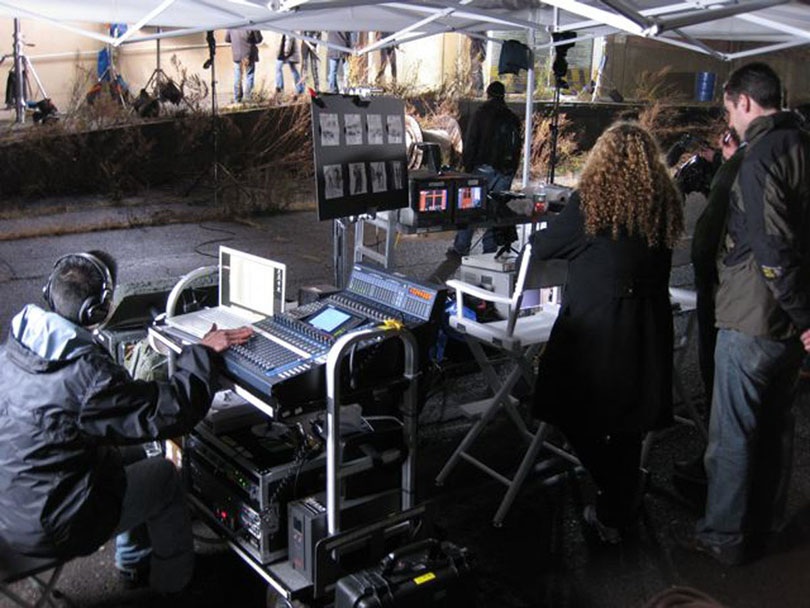

Old December 17th, 2008, 05:47 PM   #15
Location: Baltimore, MD USA
Posts: 2,352
Yamaha DM1000 if you have juice. Here's Gregg Kita on the set of "She's Got The Look."
Regards,
Ty Ford
