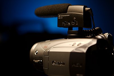

The most popular consumer camcorder mic is the RODE Videomic
While I like that mic another option to consider is the The Sennheiser MKE400 Shotgun Mic
I feel that while the RODE Videomic sounds better musically - the MKE400 is tuned for dialogue. Voices will sound better with the MKE400. Both the MKE400 and the Videomic have 1/4"-20 threads at the bottom - in addition to the cold shoe mount.
The form factor of the HG20 partners well with the MKE400. Now, if you want to shoot outdoors, the optional windmuff snaps on easily and adds great wind protection - even has a bit of dead air space.
The RODE windmuff aka "Deadcat" on the RODE slips over the foam and begins to look a little menacing. Great if you want to look more pro, but if you want incognito go with the Sennheiser. If you want better sound and don't mind the size and want to save $50 - go with the RODE Videomic - either way, you're going to be impressed with the improvement over your stock mic. A wide angle lens will also help you in getting closer to your subject - you can get 30% wider image with an adapter - that extra step or two that you can take in towards the sound source may often double your levels - resulting in much cleaner audio.

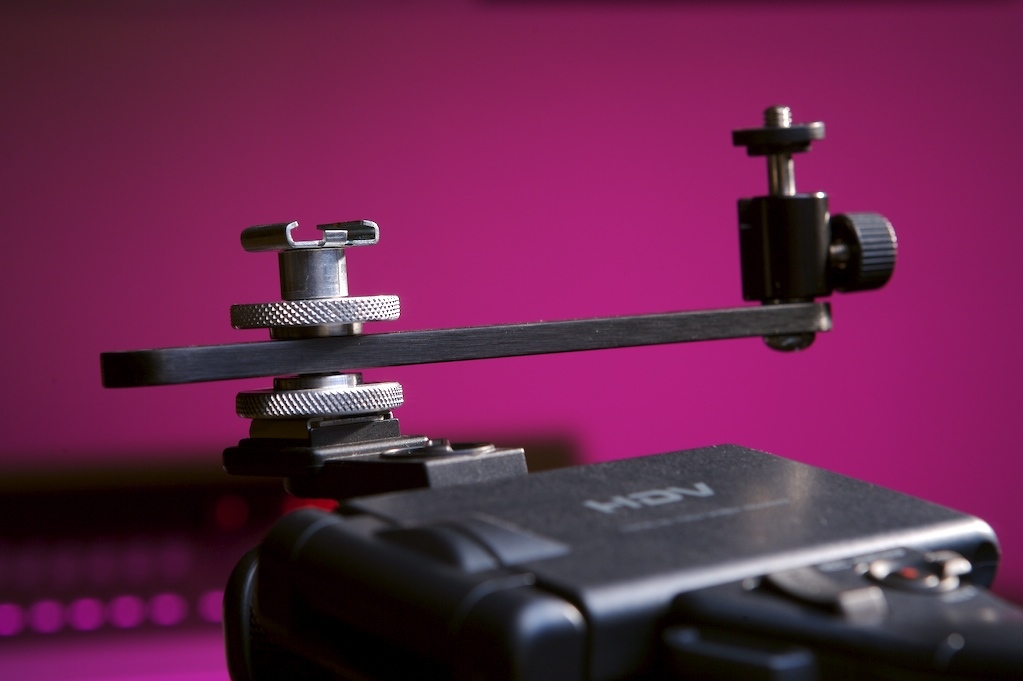

I would also look at a Bracket 1 mini or a http://www.dvcreators.net/hama-delvc...oe-mount/mount to push the mic a little bit away from the noisy mechanical noises of the camera.
Make sure to monitor with headphones and carry extra batteries. That's the drag about these little mics taking batteries and having switches - you might forget to turn them off and if you are not monitoring with headphones, the battery could die and you have zero audio. So be careful - good luck!

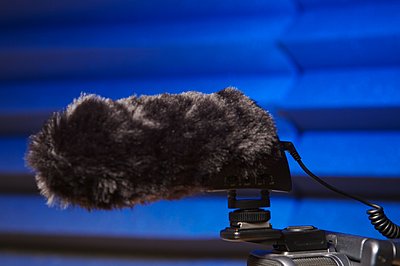

Here's a couple of pics I had saved of the Sennheiser MKE400 on the HV20.

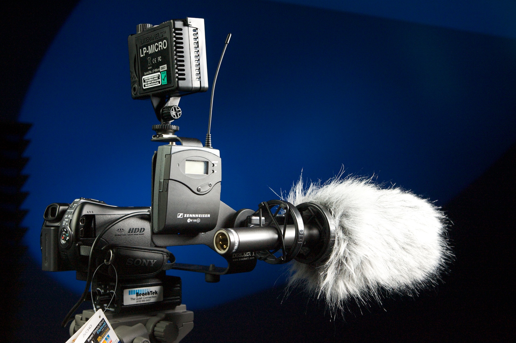

And if you want to go completely nuts go for a bracket1 with beachtek or a juiced link along with the RODE NTG-1 or 2.
