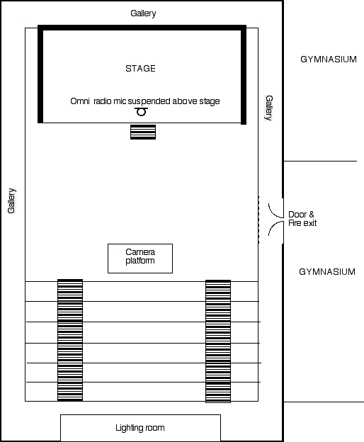

Any suggestions for improving the audio here in the following scenario.
Location (see diagram) - a small theatre in a school.This theatre is built next to (wait for it) a suite of gymnasia. No problems when gyms are not in use, but major probs when there is a game of basketball or whatever through the wall from the theatre. There is a communicating door (which is a fire exit) with the gym and a much of the noise seems to come through that.
I have to record a succession of scenes from plays (2 - 5 mostly inexperienced actors) with audio recorded clearly enough to assess the actors' skills. So far I have tried:
(a) Different number of cardioid studio condensers hung over the stage (1, 2 or 3). This was time consuming to rig and the three rig needed a mixer in the chain. The sound wasn't that good.
(b) Shotguns pointing at the stage. This resulted in dead areas as the actors moved unpredictably off mic, and there was a huge drop off with distance. Rejection of noises behind the shotguns was disappointing as well.
(c) A single omni radio mic cunningly suspended from a powered projector screen above the front of the stage - can be raised or lowered quickly and is out of harm's way when not in use (very important in a school). This is the best yet, it picks up evenly from the whole stage area but the noises from the gym are quite loud at times. A low cut filter helps with the earthquake noises of kids running, but not with the shouting.
The whole stage area is in use, and it's different every time. Not the easiest job I've tackled. Given that blocking off the fire door, using boom operator(s) or individual radiomics are ruled out, any ideas I hadn't thought of? No probs with the video, thank heavens.

Have you considered boundary or PZM mics. Three or four across the front of the stage in addition to some plant mics hidden in on the set works OK in some situations.
Otherwise the small goose-neck choir mics cardioid or hyper-cardioid is another option. Better than shotguns for interiors.
Nothing like having the talent wired though.

Actually, Rick, I hadn't thought of these. I have zero experience of boundary mics. Perhaps I should do a bit of research on them?

Sorry for delayed reply. I had a look at the links and I would using consider that for another gig. Unfortunately I can't put anything visible on the stage or between the "audience" and the stage this time. Thanks for that suggestion anyway.
