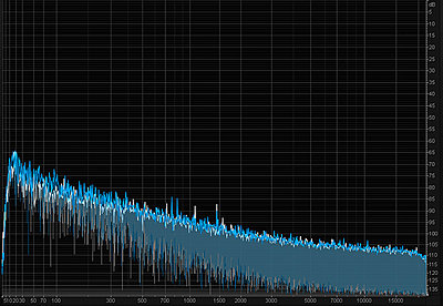

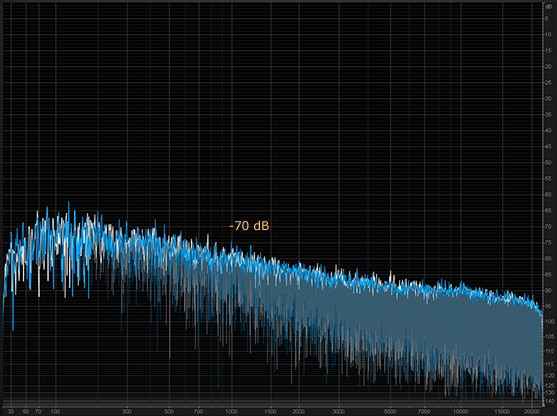

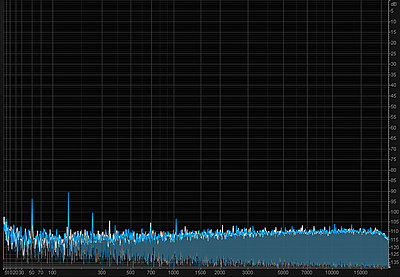

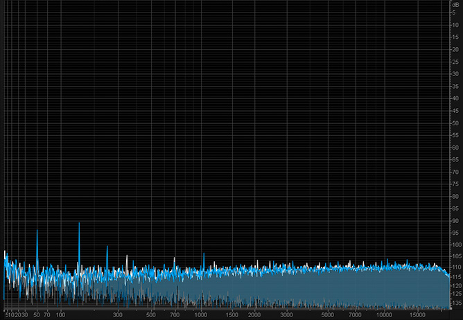

Old September 7th, 2009, 05:21 AM   #28
Location: Groningen, Holland
Posts: 4
Recently I could compare recordings of "silence" made by Alastair and me.
The recordings were made in a quiet room, gain was set at 10.
My impression is that there is no significant difference between
the two recorders (at least when gain is set at 10).
SonyInGain10.jpg = spectrum of my Sony.
I've tried something else.
I connected 2 K3 Sennheiser mics through the external mic input.
Gain at 10, highpass filter was on, 24 bits, 44.1 kHz. And the "silence" was recorded.
Senn 10 On.jpg = the spectrum when the Sennheisers were on.
So it's the noise of the amps + mics + silence.
Senn 10 Off.jpg = the mics were still connected but off (no signal from the mics).
It's the noise of amps only.
The spikes at 50Hz, 150Hz and 250Hz are strange since the recorder is powered with batteries.
As you can see the amps seem to be OK, noise less than -105dB.
So, what does it mean?
The silence was not that silent (I doubt it) or
the mics, both Sennheiser and Sony, are too noisy (that's what I think) or ...
I'm afraid we are at the beginning.
Excessive PCM-D50 noise level?-senn-10-.jpg   Excessive PCM-D50 noise level?-senn-10-off.jpg
Andrzej Duda is offline   Reply With Quote
