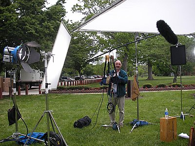

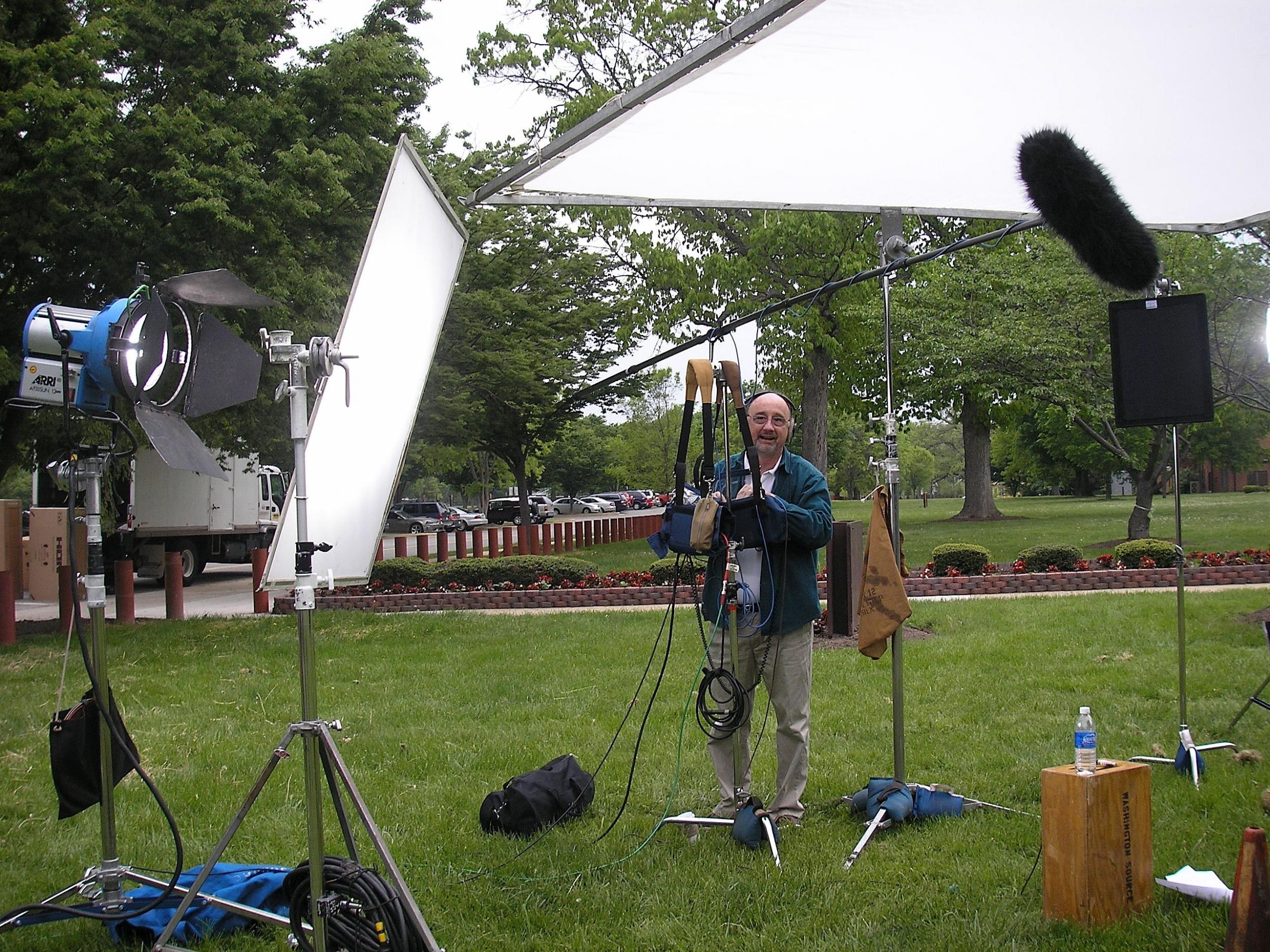

Originally Posted by Les Wilson View Post
I've used a Shure FP31 field mixer a couple of times in the last year. Recently I had no sound person and had to do it while shooting from a tripod. In that situation, do you wear it, mount it on your tripod or what?
TIA
I use a light stand. Usually the one I put my boom rig on. In this shot, they loaned me a C-stand. I rigged it with my knuckle and boom pole holder.
The two blue bags are my 442 mixer and 744T recorder.
Regards,
Ty Ford
How do you mount your field mixer when you have no sound person?-applecoxtyford2-.jpg
