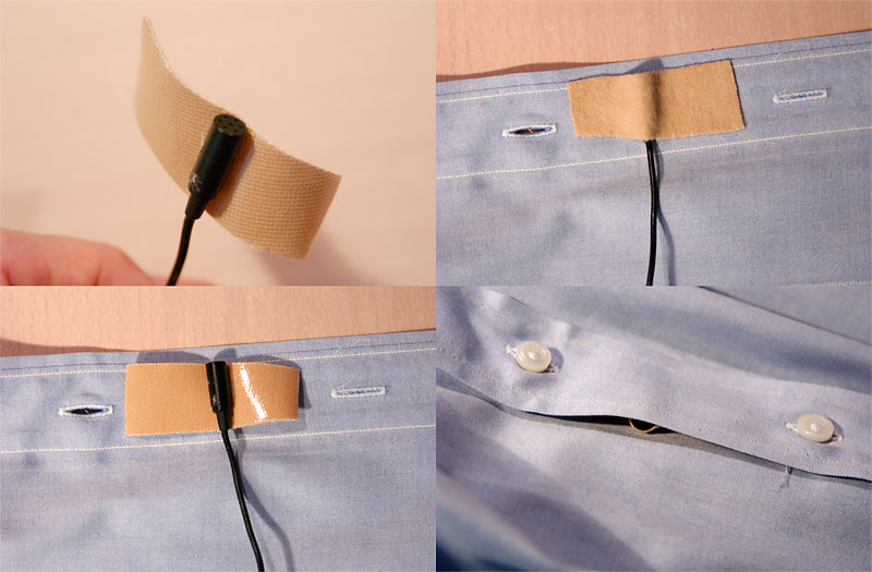

I conceal these a couple of ways, for most cases. For a guy with a buttoned-front shirt, I use a strip of moleskin about the width of the shirt's placket (the fabric strip through which the buttoholes are sewn) and just shorter than the distance between two buttons.
Then, use the moleskin to stick the mic horizontally to the back of the placket between two buttonholes mid-chest, with the element barely peeking out of the moleskin strip, but not visible from the front. I use another small strip of moleskin against the shirt fabric close to the mic to control the cable and dampen cable noise.

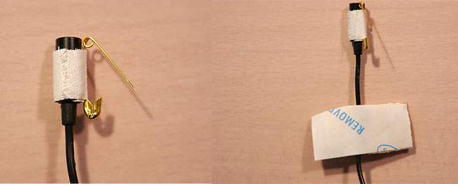

For women, I often tape the fixed side of a tiny safety pin ( the ones that close ) to the mic, lengthwise, with a small strip of gaffer tape. I leave the side that opens free. I put a small strip of moleskin, say 1/2" by 1-1/2" crosswise on the cable an inch or so below the mic. I have the woman open the safety pin and stick the pin vertically through the center of the bra strap, then close the pin. She then sticks the moleskin "wings" to her skin below the bra, which secures the cable.

Here are a few pics of the lav mounting technique I was talking about before.
The first is the man's button-front shirt mount. The second is a mount for a woman's center bra strap.
