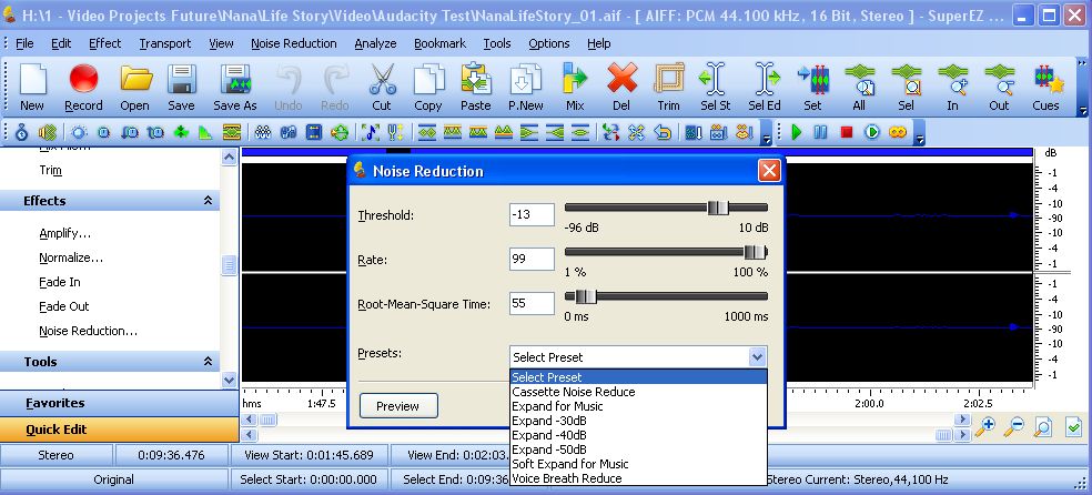

Jon, I'm finally getting around to trying this. I have Gold Wave Pro (SuperEZ Wave Editor Pro) trial installed. I've highlighted a small region, pressed the Ctrl+C, then opened the Noise Reduction Effect window. My problem is that I don't see the Preset "from clipboard" anywhere.

On my version, you highlight the noise, copy (Ctrl-C) the noise sample, select the entire range that you want to affect, then open the menu Effect | Filter | Noise Reduction. In the "Reduction Envelope" area, there's a selection for...
( ) Use Shape
( ) Use Current Spectrum
( ) Use Average
(*) Use Clipboard
Best of luck!

Old August 29th, 2009, 01:01 PM   #8
Location: Gilbert, AZ
Posts: 92
Looks like I must have a different version. Any idea what settings to use?
Ken Olson is offline   Reply
