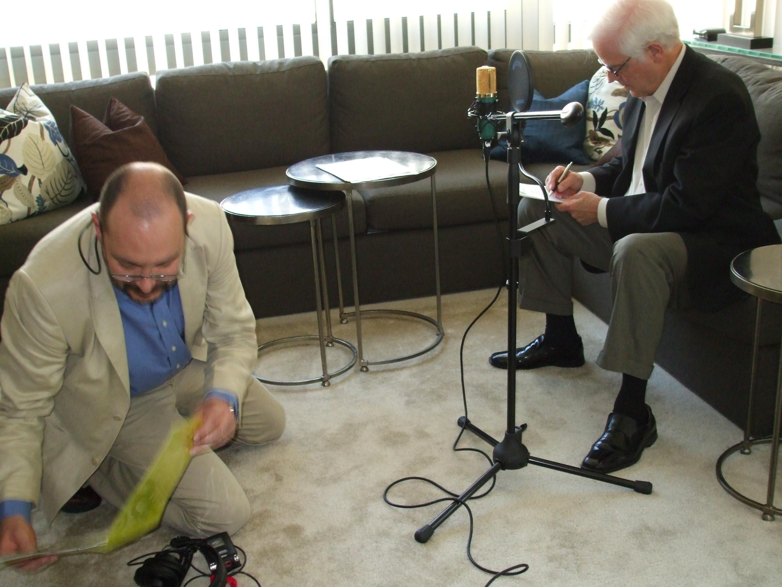

Ken,
an ME66 for a VO?
Hey, I'm no expert, but I wouldn't do VO with that Senny
(which I do own, but never use indoors).
Being an El Cheapo kind of guy, I bought a Marshall MXL V67
(you can get it now for $80: MXL | V67G Cardioid Microphone | V67G | B&H Photo Video)
pix caption:
the MXL V67 in an improvised setup
(with ENG-44 audio mixer - not visible - and Edirol R-09)
By the way, the gentleman taking notes is Mr. Nick Clooney (George's dad)
who very kindly volunteered to do a quick VO (for free!!!)
in his Newseum (Wash., DC) suite...
It worked (once the AC finally decided to give us a break)
Best
Vasco
