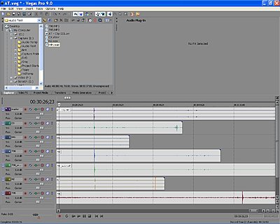

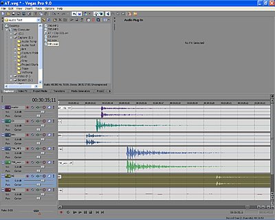

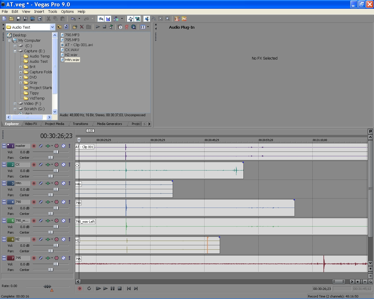

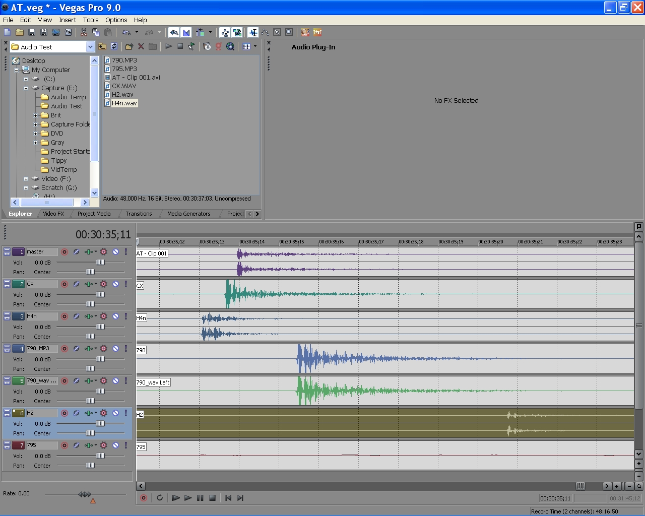

This is not a scientific test by any means, but it does show how each recording device syncs up with the camera audio. All devices were set up as close together as possible. I let the camera (FX1000) and recorders record for 30 minutes with a clap at the beginning and another at the end. The CX, H4n and H2 were all set to PCM 48kHz/16 and the irivers (790 and 795) set to there best 44.1kHz/160KBPS. I did convert the 790 mp3 to 48kHz wav file using Vegas, but the mp3 and wav were exactly the same.
Results: 1st - Yamaha Pocketrak CX - ½ frame to fast
2nd - H4n - 1 fast
3rd - 790 - 1 ½ slow
4th - H2 - 6 ¾ slow

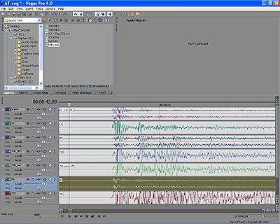

5th - 795 - off the chart
Sync Test: CX, H4n, H2, irivers-sync_in.jpeg   Sync Test: CX, H4n, H2, irivers-sync_out.jpeg
Sync Test: CX, H4n, H2, irivers-795.jpeg
