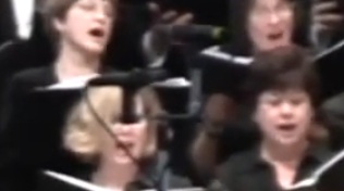

Don't know that any of this helps but...
I can't identify the specific microphones, but in listening to that again with the HD option on the video, it looks more like a crossed pair, vertically offset (not that it matters). I would opine that the relatively good quality of the audio under less than ideal conditions is a tribute to the auto gain circuitry of the camera which can just sometimes do a better job than an inexperienced operator using manual gain.
Another factor is that the ensemble is particularly well acoustically balanced - well done the conductor and the (probably scratch) orchestra who are particularly well in tune (bravissimo, D trumpets)! Just a pity we can't hear the organ continuo. The occasionally flat sopranos could have been corrected in a studio recording but it's not really that noticeable. The (as usually considerably outnumbered) tenors and basses are doing a sterling job.
(Ignore all this by all means - I'm being a bore. Almost certainly too much unnecessary information, and some of it opinion rather than fact).
Attached pic of mic array:

Damned if I can tell much about the mics from watching - other than noticing that there seemed to be a couple of mic stands on stage as well. One looked like it had a dynamic mic on it for announcements etc but couldn't clearly see what was on the others.
Location of the large mic stand did seem to be pretty good, but as has been said, a bit too low. In a situation like this when the group is elevated and I'm on the floor I sometimes put the mics up on a 12 - 15 foot light stand just to get well above the conductor's head. Anyhow, without hearing the other recording it's hard to know for sure but I suspect it was pretty good - of course, the type of mic used would play a part in the result.
