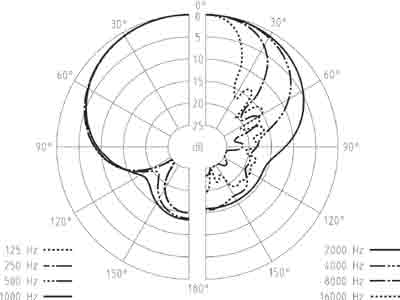

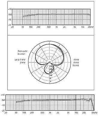

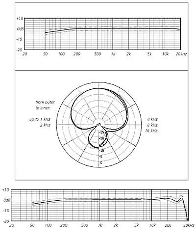

Old April 3rd, 2010, 12:29 AM   #8
Join Date: Feb 2004
Location: Southern, CA
Posts: 198
Here are the 641 and 416 pickup patterns.
Kirk Candlish is offline   Reply With Quote
