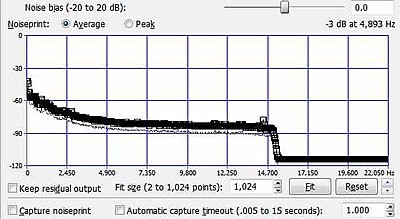

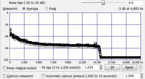

My ears ain't what they used to be, so here's what my analysis indicates.
http://i897.photobucket.com/albums/a...AT898noise.jpg
The HF drop-off is normal for 256kbp/s stereo MP3.
