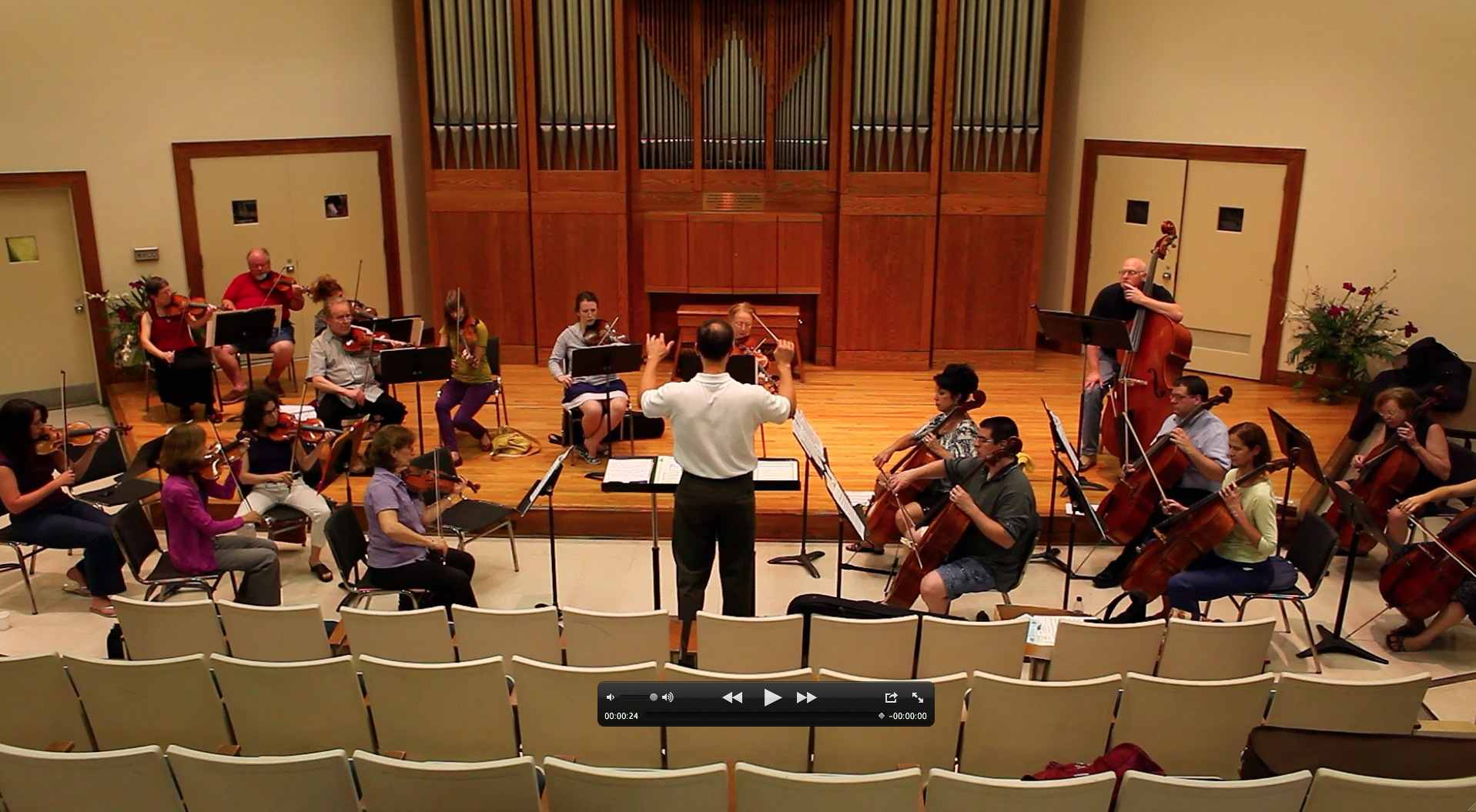

What should the mic arrangement be (x/y, ortf, etc)? I know this is something I need to try out at the dress rehearsal, but from your experience what would you recommend? Below is a screenshot from a quick video of the orchestra at the venue they've been practicing in (the one for the concert is different). This is their setup:

What happened to the instruments that normally fill that huge hole in the middle? As a first try I'd put a stereo pair on a stand in the middle between the second and third row, directly behind the conductor, right where you see those dark "cup holders" on the back of the second row of seats, then tweak it from there. Experiment with both X/Y and ORTF, they're not THAT different, and see which one works best in this environment.

Oh. So the mics should be placed directly behind and above the conductor, but back in the second/third row seats?

Not engraved in concrete but that's a good starting point. The exact placement needs to be worked out on a case by case basis.

Yes - ORTF pair of your NT5 (don't use the other mic.) behind and above the conductor and I would say the second/third row would be about right.

Agreed, but the above *is* a good starting point.
