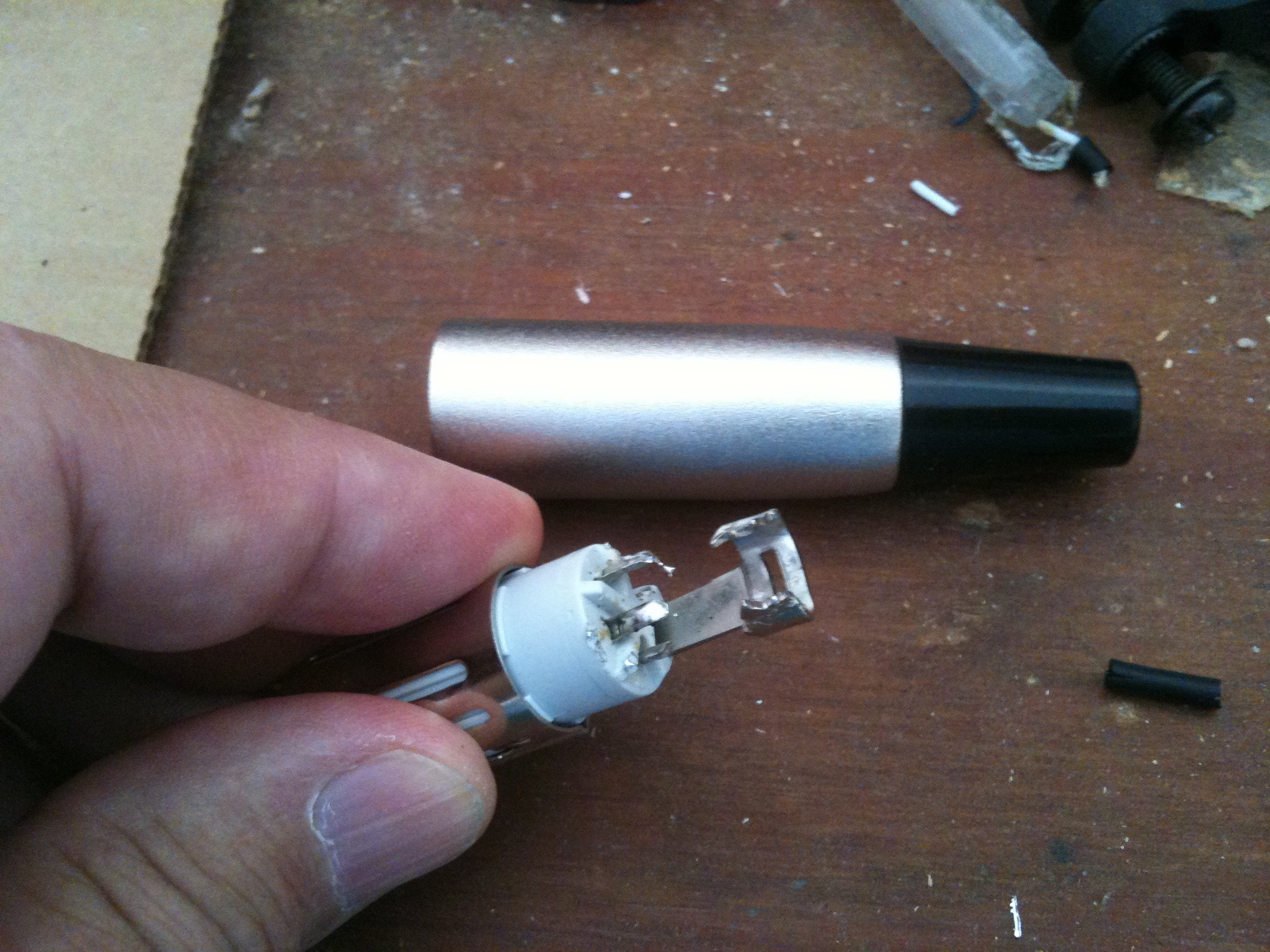

Originally Posted by Richard Crowley View Post
...If you think that a Switchcraft has any kind of crimped strain relief, then you aren't talking about the kind of Switchcraft XLR-style connectors the rest of us recognize.
If they aren't Switchcraft, then I stand corrected about the crimping and cheap solder terminals. The attached is from a 5 year old Production Intercom headset that failed after less than 50 insertions. Sure looks like the type of Switchcraft in the market Neil was looking:
Can you post a picture of a "real" one? I'll open up the other ones in the repair bin I inherited and compare.

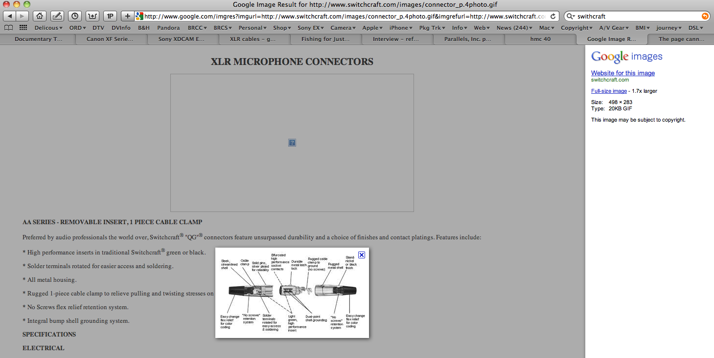

From the Switchcraft website:
Old August 5th, 2010, 09:26 AM   #20
Location: New York City
Posts: 523
I've only used DIY brand!
Both switchcraft and neutrik have different lines of connectors. That switchcraft above could be fake? Looking closer, I don't think it is a switchcraft. Looks vaguely similar but its a knockoff.
For heavy duty use, I prefer switchcraft The housing is really beefy and up to being driven over (probably). On male Neutriks, that little retention tab can break fairly easily--not a deal breaker as by the time it does break, it will also be slightly deformed so there will be a tight connection.
Neutriks are much easy to solder. Switchcraft has their picture under PITA in the dictionary. If you're gonna build a lot of cables, I'd hate to be using switchcraft.
Canare is the gold standard for cable but other shielded quad cables are OK too. For whatever reason, most of 'em are tricky to solder.

Old August 6th, 2010, 12:13 AM   #23
Join Date: Aug 2007
Location: Portland, Oregon
Posts: 1,238
I couldn't find a photo of the innards of an A3F (female as you have), but here is a photo of an A3M and the insides are virtually identical.
http://chesterelectronics.com/images/A3M.jpg
I've been using Switchcraft connectors for almost 50 years and I've never seen a connector like the one in your photo, except as a cheap no-name knock-off. If they used such a cheap connector, I would expect the rest of the apparatus to be equally shoddy. My sympathy to you.
