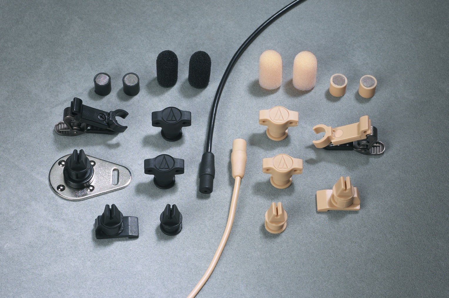

Be sure to order the right one, the 899 comes either with an XLR or unterminated (bare wires).
The TH denotes Theatre (beige, flesh tone, pink)
It's a pretty decent sounding lav at the price and I love the fact that it ships with a vampire clip as well as an assortment of other rigging options. I used to have one, but now switched over the COS11D with the vampire clip from LMCsound.
Here is the link to the 899 on AT's site Audio-Technica - Microphones, headphones, wireless microphone systems, noise-cancelling headphones & more

Their stock photos of the two mics on the Dolphin Music site are misleading, read the full description to see the difference. The less expensive version (AT899c-TH) is just the lav mic with a connector to attach to a wireless transmitter.
The full version AT899 has the XLR power module which allows it to operate as a complete wired microphone.
