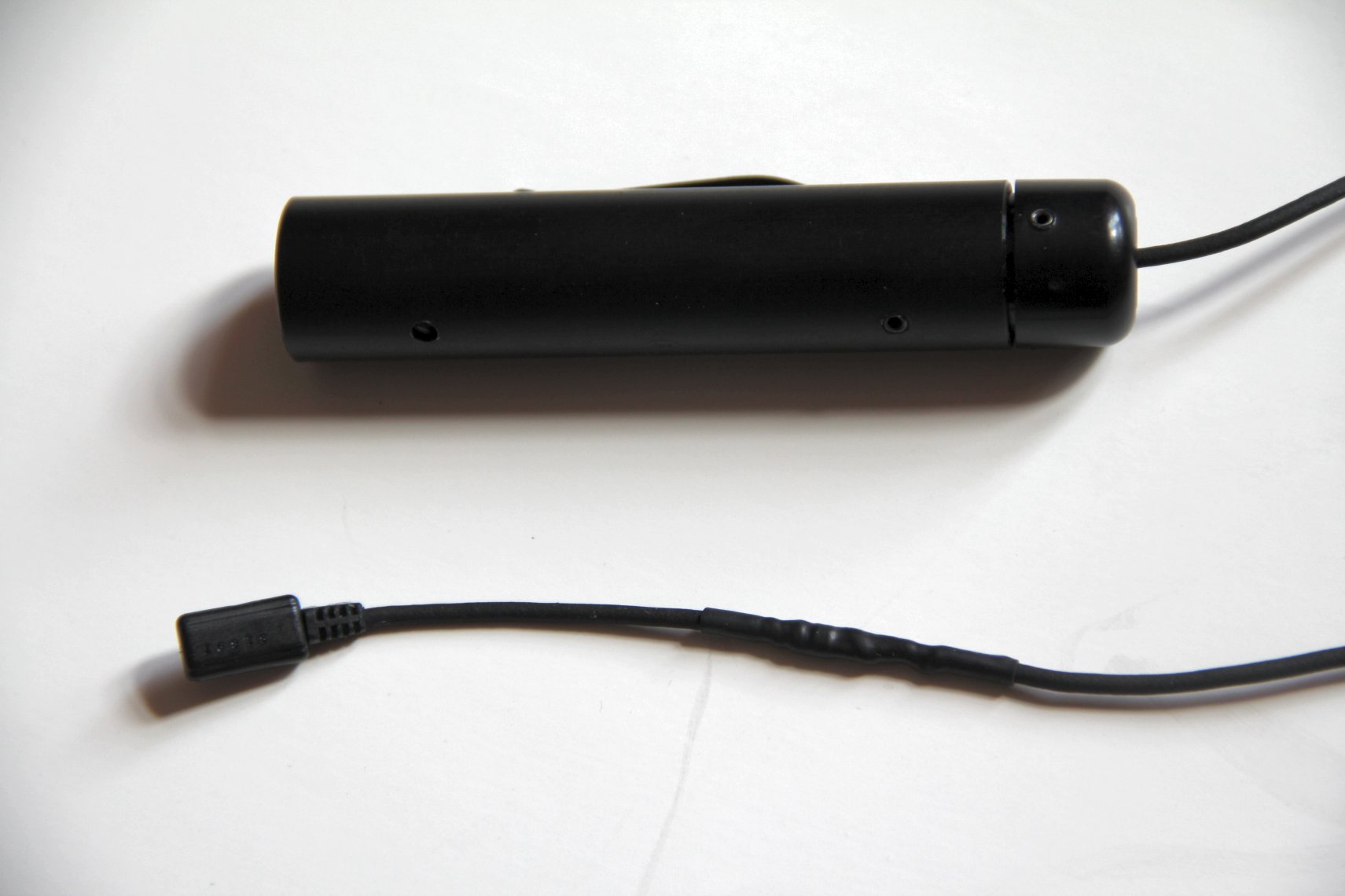

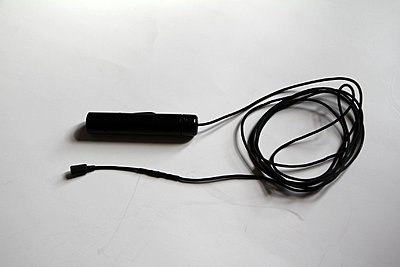

Already fixed and mailed back. Publicly awaiting Ben's rating.
lav mic cable SEVERED- fixable?-cord1.jpg   lav mic cable SEVERED- fixable?-cord2.jpg

Looks like a good repair to me. Hope it works for you for many more years.

Tom is the man- the pictures say it all, and mic is good is new. What seemed like an impossible fix was apparently simple to Tom as he received, repaired and mailed back same day- *without even mentioning money*.
