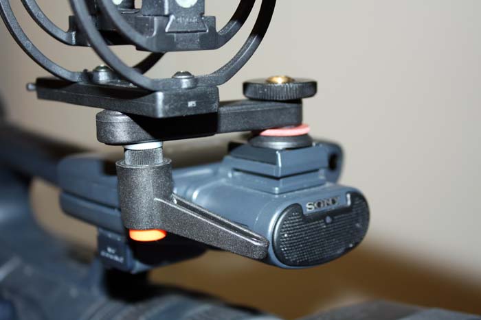

Can you fit washers to tighten on?
Cheers.
Old December 15th, 2010, 07:30 PM   #17
Join Date: Apr 2009
Location: Arcata, Ca
Posts: 750
Probably on the main one that slips...

Hi Chad,
I occasionally had that problem with the NTG-3 on my EX3, at the start. As you know the all metal bodied NTG-3 is a fairly heavy mic for it's size/length. I've just got used to tightening the Invision Video assembly with a bit more force and it's rarely an issue. In fact I like it this way - if the mic gets knocked during run-n-gun or carrying the cam around I know it will "give" (at least in one direction, horizontal) and so lessen the risk of damage to the mic.
However, Allan's idea is a good one. Just had a quick look at the assembly and I reckon there is about 1, maybe 2mm extra thread length available on the two main adjusting screws which should allow the addition/insertion of "high grip washers" on the touching surfaces to reduce this "slippage", if needed. As you know, the whole thing can be taken apart with ease so it should not be too much trouble to add these as a DIY retrofit.
As to what these high grip washers should be made of/where you would get them I don't know what to suggest...anyone got any ideas? Maybe some kind of fiber washer?
Not withstanding that, I suggest you contact Rycote directly with you observations/concerns. I've found them to be very, very responsive to customer feedback.
EDIT: Also, in answer to your question "Perhaps there is another way to configure it?" - On my Invision Video there are TWO positions for the bolt hole, one at the back near the clip and one under the Lyre suspension. Maybe switching the bolt position will help. I originally used the one at the back (see photos in my mini review) but have now switched to the "under Lyre" pivot point. Hope this helps!

Hi again Chad. I contacted Rycote about your concerns and this is the reply from Simon Davies which he's happy for me to share with everyone - direct quote pasted below.
Within the Universal Camera Kit there is a quick & easy solution to the issue of rotation of the main cradle on the InVision Video. The bolt which passes through the bar is a Metric M6 thread, and as you've pointed out can be position forward or back depending on the weight distribution required. The lever ratchet arm (the part with the Orange button) used on the "boom swivel" fits the M6 thread. If you remove the M6 thumb wheel from the bottom of the InVision Video, and replace it with the lever that will cure the issue of heavy mics loosening the thumb wheel. We originally design it with thumb wheels rather than levers or knobs to allow maximum rotation & therefore flexibility. Here's a link to the Boom Swivel image on our Flickr site:

The other thumb wheel is a slightly more difficult issue that we've not had before. The thread on the brass shoe is 3/8" BSW, and we don't have a lever or knob with a 3/8" insert. However, I've tried the mount here now with a fibre washer the same we use on the top of our boom poles, and this does add some grip over the thumb wheel alone. I've attached a shot of the set up.... the lever + nylon washer on the left, and the pink washer on the right. It would be great to hear the general feedback, so please feel free to share this to the forum if you'd like.
[End of quote]

Old December 16th, 2010, 11:08 AM   #20
Join Date: Apr 2009
Posts: 750
Thanks Andy!
I will check this method out. But when you say "Fiber" washer, what is the fiber? The pink washer looks like rubber. Would that work? I have some rubber I could cut out, or I can go down the street to the hardware store and get something. Like I said the part that slips the most is the part that in the photo above has the pink washer and brass bolt.

I think (from my many happy times of working in the good ol' USA) you guys call it fiber? I think we tend to spell it fibre. But both spellings are correct and often interchanged (according to a quick web search I just did). Basically, I was referring to a fibrous (rough textured) washer that will partly compress under pressure and provide more friction to movement. Typically these are made from some kind of polymer. Does that description help?
Rubber or a rubber 'O' ring should work pretty well if you have something you could try easily to hand, I imagine. (We won't get into US versus UK various meanings of the word rubber!)

Old December 16th, 2010, 05:44 PM   #25
Join Date: Apr 2009
Posts: 750
Well I went with the rubber washer, and it seem to have given me more grip. The fiber ones seemed too stiff. I'll live with this a while and see how it goes. Next thing is to find out how to counter the front heavy drupe of the mic.
