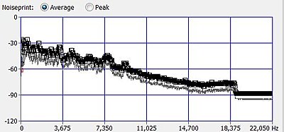

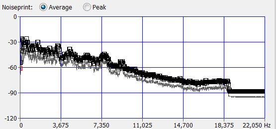

Aaargh! You have a real problem --- a broad spectrum high level noise, plus a still camera clicking at a very high level. I played with a noise reduction program in Sony Sound Forge --- there are lots of others --- to see what I could do....the filter in the program made the voices more recognizable, but nothing, I think will eliminate the noise as it overlaps the vocal range of the speaker. The clicks, I just cut out altogether, as they completely mask the speaker. I'm also attaching a spectrum analysis of a sample that had just noise, without the speaker present. You might like to try SoundSoap or another special-purpose noise reducer, or to start, the noise filter in Audacity (excellent freeware). Good luck!

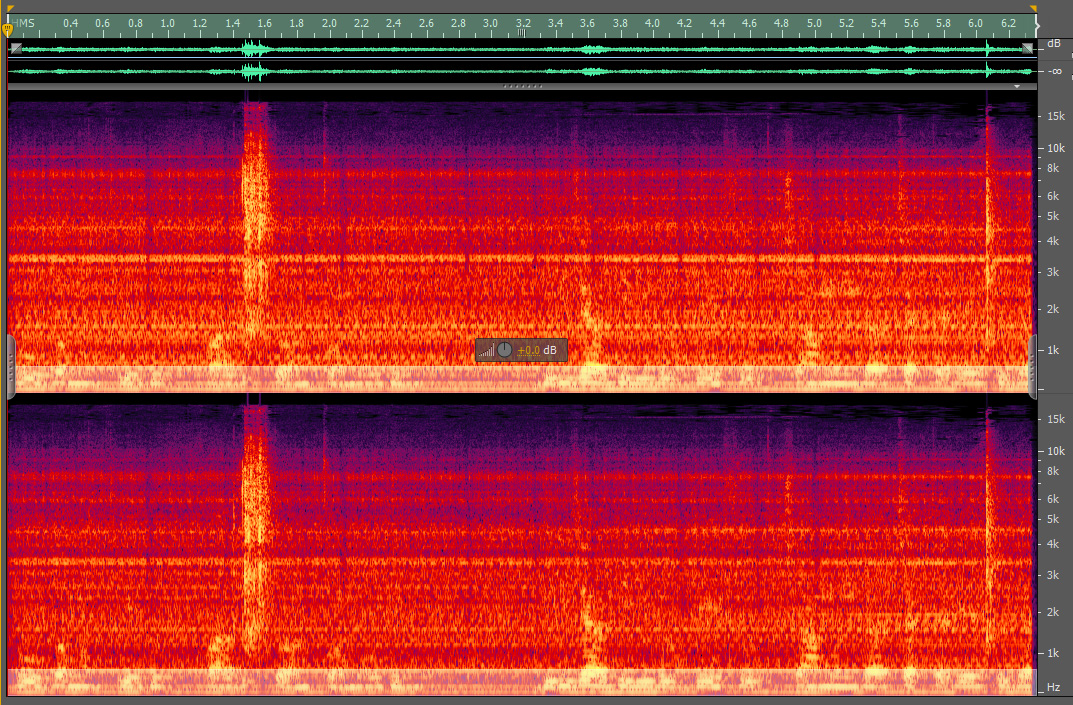

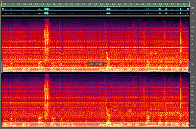

The spectral display shows quite a mess. Wide band noise all over the place - I'm not certain there's really much that can be recovered here?

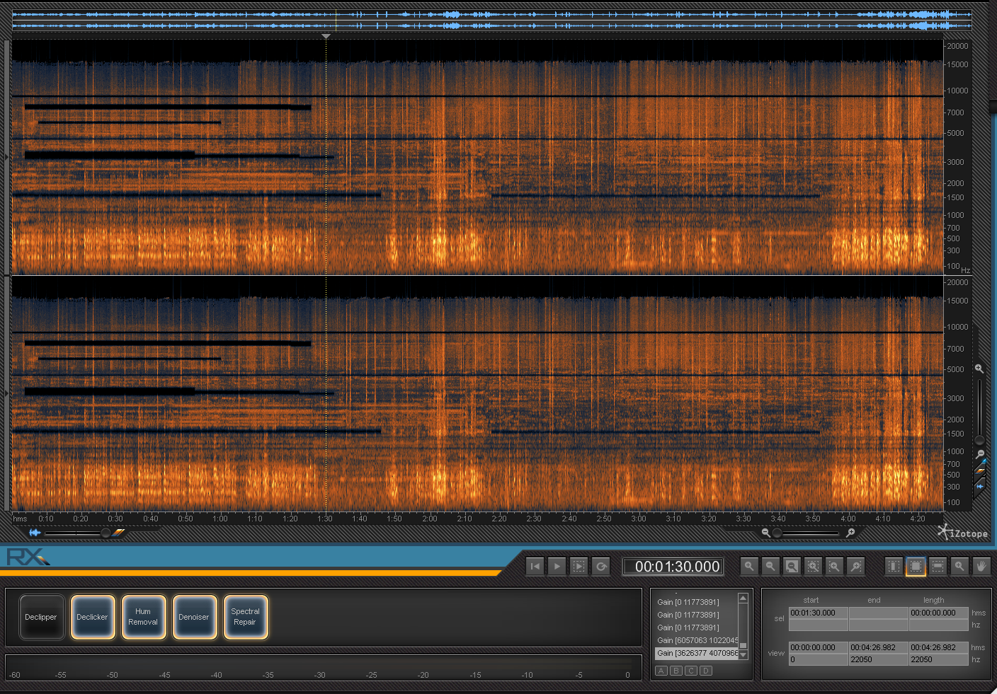

I just took a crack at it with RX. Man is that a loud buzz! First off I removed the 60cycle hum, which helped. Then ran a "declicker" to lower some camera noise. I tried selecting a section of the noise between dialogue parts, and using denoiser at -6db, and that helped somewhat. You can at least almost hear the dialogue. Also you could go through and select each of the long horizontal lines (in the orange spectrum display) and use the gain (shift+6) to remove them one by one. Or at least select the brightest lines at the bottom then turn them down all the way.
The problem is that the noise is louder than the signal (voice). Couldn't you hear that when you were recording? Anyway, you may be able to make it so you can hear the voice, but there's no way you'll have the voice sound "good".

I'm trying to attach an mp3 of the whole file, and a wav of a small clip, and a png image of what the spectrum looks like. I think your clip sounds better than mine. I did hum removal, deNoise, once over the whoe file, and again just in the middle band where it was the strongest, then I removed some camera clicks, then selected the tones caused by whatever machine that was, and reduced individual bands.
I think your bit sounded better than mine Jim.
