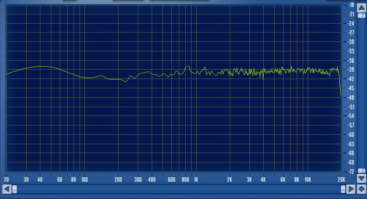

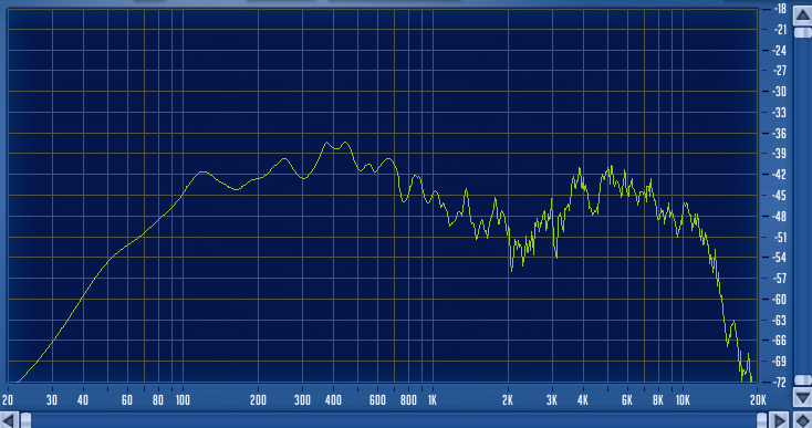

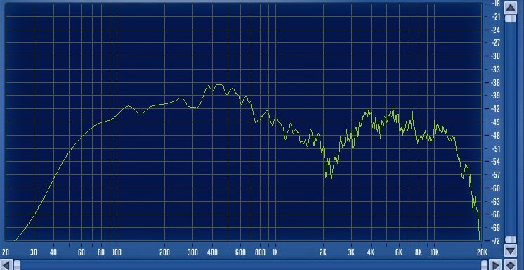

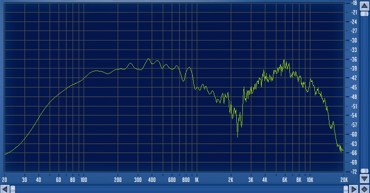

I have a vintage black ME-80 that I am trying to test. It sounds fine, but it's a little low on sensitivity. I also have an MKH60 and ME66 to compare. I created a pink noise wave in Soundtrack and recorded this ouput on our studio monitors with each mic. Next I ran a spectrum analysis on the waveforms I recorded.
But there's a dip around 2k on all of them. I think this is the studio monitors.
What's the best way to compare these mics other than ears?
I am attaching the waveforms.
Dave
Testing Shotgun ME-80, MKH-60-digital-pink-noise.png   Testing Shotgun ME-80, MKH-60-me80.png
Testing Shotgun ME-80, MKH-60-mhk60.png   Testing Shotgun ME-80, MKH-60-me66.png

Well... the only proper way to measure the response of a mic is in an anechoic chamber with calibrated equipment, otherwise you're measuring your monitors, the mic, the preamp and your room combined. and besides its only the ears that really matter anyways.

depending on how the mic was stored or taken care of makes a difference in how a mic "ages" the sound will change with age due to all sorts of factors, moisture, dust, heat, and many others.
condenser mics use electronics as well and capacitors age as well changing characteristics of sound as well. Heck that is what drives the "vintage" mic market.
since you probably do not intend on refurbishing the mic, then I don't see a reason to measure it against another mic on paper response other than to see if it has certain anomalies as huge spikes or dips at certain frequencies. and you already made that comparison.
and like I said in my previous post, it is all in the ears, you cant hear a graph.
consider it another flavor in your pallet of tools.
if you need to cut in this mic along with others, then learn the differences by ear, the graph can lead you to the proper frequencies, but ultimately only your ear can tell when it sounds the same. that is the art of audio engineers, just like a DP selects a lens, not based on specs but on the look it creates.

IMHO, the fact that you live in Florida would be a primary contributing factor in how your mic has aged. The actual mic diaphragm is always susceptible to humidity, mold and fungus, amongst other things and decades of being moved by hot moist air from people's lungs contributes to this also.
If you value the microphone and want to keep using it, a trip to an audio repair facility might be in order as they can better disassemble the mic to clean and check out the diaphragm and associated electronics path than you can. Typical deterioration symptoms in older mics would be loss of frequency response and loss of output. At its inner most core, all a mic is is a housing for holding a diaphragm and electronics. Most pro audio facilities charge around $50.00 to $150.00 per hour so you have to balance what the mic is actually worth versus if it is worth sinking money into for cleaning and or repair. Might be time to retire it if it is sounding too old or has too little gain left in it.
