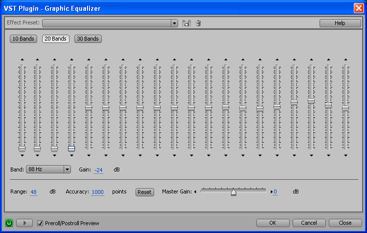

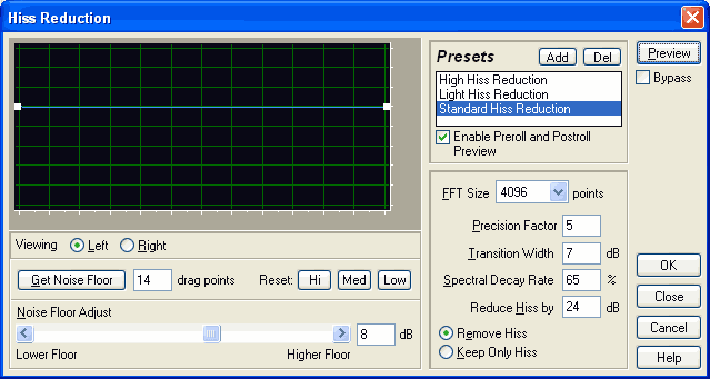

is there a way to show me the graphic equalizer?
Scott Hayes is offline   Reply With Quote
Old December 27th, 2010, 09:35 AM   #7
Equal Opportunity Offender
Location: Brisbane, Australia
Posts: 3,196
For sure. (and I totally understand the need)
See attached.
Andrew
interview problem-hiss-reduction-process.gif   interview problem-graphic-equaliser-stage.gif
