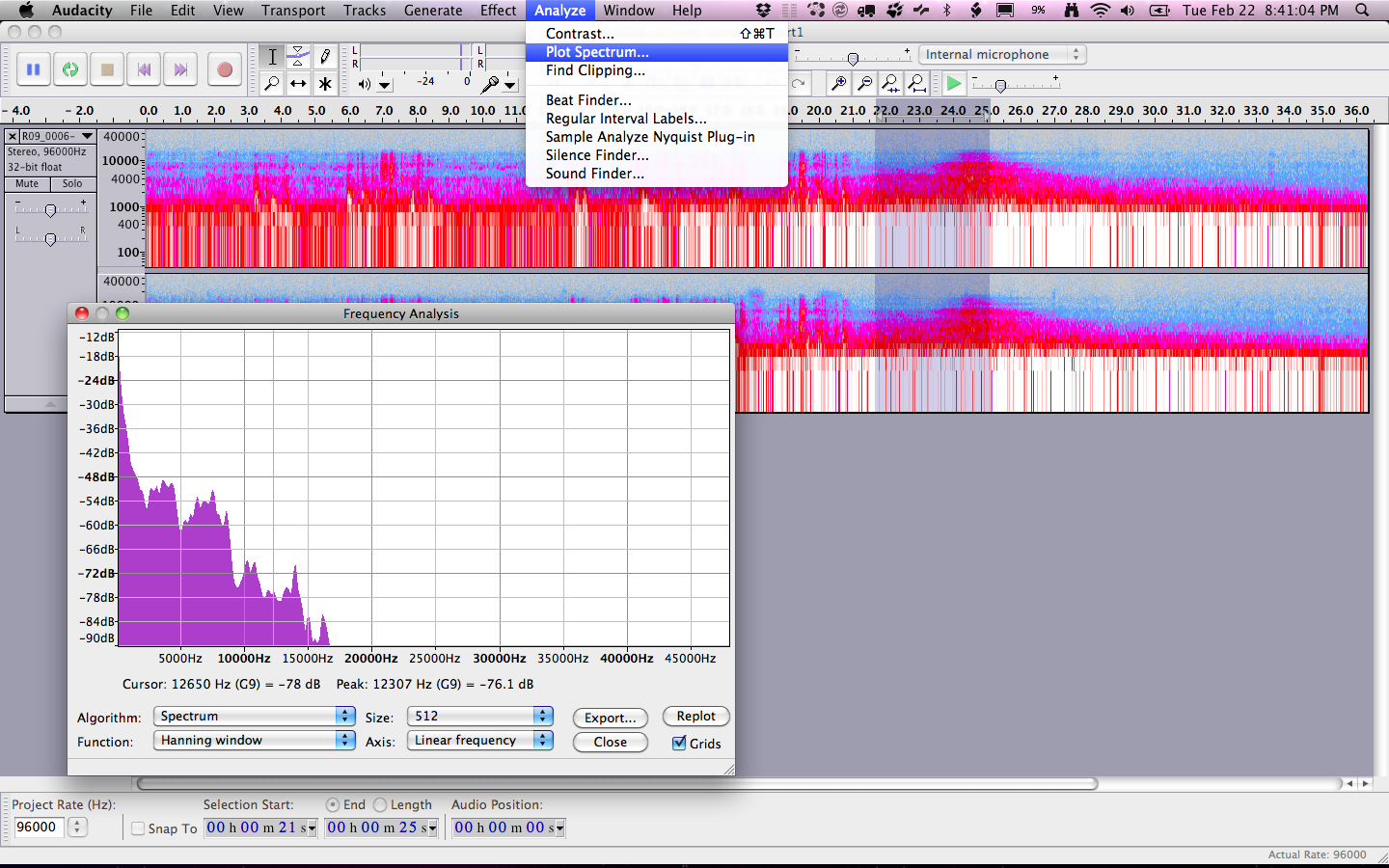

Hi Robert! Many thanks for the help! I really appreciate it. :)
First, how the heck did you get embeded images inline with your your post!!! I see you are using "attach" and then the ID of the attachment. Pretty cool! I will have to play around with this the next time I want to post images inline with my comments. :)
Originally Posted by Robert Wiejak (Post 1615302)
Gentleman,
I will admit that I have not read the whole post, but I listen to your sample and found your ‘clicks’.
To me it looks like hardware, maybe power supply problem.
Take a look at the first picture and see where the click is in that waveform.
Ugh, I would hate for it to be hardware related. :(
I can't really afford to re-buy a recorder and/or binaural mics.
Do you think it could be the battery pack?
In the last tests I did at home I did not experience any cracks/pops, but then again the bass was not as deep, although I did have my head right up next to the speaker (and it was turned up loud... My wife kinda got pissed at me that day). :D

By the way, does Audacity have a Spectral view, so you can easily locate the clicks? And did you have a chance to try correcting any of them on your own?
I have not had a chance to try and fix, but I am planning on spending some time this weekend to do just that. If I make some progress, I will post my results. :)
Looking at Audicity, there is a "plot spectrum" in Analyze menu:
Attachment 21614
Gosh, I really wish I had CoolEdit Pro!

OK, Micky, here are a few screen captures to show how the Spectral View (in CoolEdit Pro) is used to find the clicks in your file. You already know how to fix them, once you find them.
The first image (Spectral-01.gif) shows what Spectral View looks like. You need to take a minute and get your head around this, because it's so different from waveform view. The horizontal axis is time scale, same as with Waveform view. Left channel is the upper graph, right channel the lower graph.
However, the vertical axis is different. Look at the scale at the right side of the graph, you'll see that the vertical axis now represents frequency. Low frequencies at the bottom, high frequencies at the top. Intensity at any given frequency is indicated by color!
For example, you'll see that there's a thin yellow-white area near the bottom of each channel's graph. The yellow-white color indicates that those are the loudest sounds. The fact that they're near the bottom of each graph indicates that they're lower frequencies (look at the scale, they're pretty much below 1,000 Hz.)
Above the yellow, there's an area of red, which gradually tapers off to violet. Red is less loud than yellow, violet is less loud than red. That indicates that from about 1,000 Hz to about 5,000 Hz, there's still significant sound level, but it's gradually getting lower in amplitude. Above that, it tapers to darker violet and dark blue: the level is getting lower as the frequency gets higher. (That's what you'd expect in normal sound files.)
Now look at those two big vertical spikes. The color of those indicates a sound that has a lot of energy up into the higher frequencies. The fact that it's a narrow spike indicates it's a pretty short duration in time. Those are the first pair of clicks in the "snippet" file that you sent.
You'll notice that the spike on the right has a lighter blue background. That just indicates that I've selected (highlighted) that spike by dragging my mouse across it... the same as you'd select any area of any file.
The second image (Spectral-02.gif) is the exact same part of the file, in time, but here we've switched back to the traditional Waveform View. Don't be confused by the file name... this is not a spectral view. You can see the same area, in time, is highlighted here.
The third image (Spectral-03.gif) shows that I've zoomed in on the time (horizontal) scale, to the part of the file that I previously selected. I've also zoomed in slightly on the amplitude (vertical) scale. You can start to see the click clearly.
The fourth image (Spectral-04) is zoomed in even further. Now you can see the click clearly. You recognize this from the images I sent with my click-fixing explanation last week.
The point of this brief demo is to illustrate what the Spectral View looks like, and how you use it to accurately find each click in the file. Hopefully, Audacity has a similar spectral view, so you can easily find all the remaining clicks (in the file I fixed last week), and then try fixing them yourself.
Make sense?
It looks as if the spectral view in Audacity will let you see the same thing. I like CoolEdit's color scheme better than the Audacity color scheme in the image you posted... maybe because I'm used to looking at an oscilloscope which has a black screen except for where the beam traces the waveform. Maybe you can change the color scheme on Audacity so it's a bit clearer.
Note, too, that my Spectral View has a linear frequency scale, so the fundamentals are all really squished down near the bottom. That makes it very easy to spot high frequency anomalies. Your spectral view has a logarithmic frequency scale, so the spikes (which show the clicks) don't stand out as well. Maybe you can change Audacity's spectral view to have a linear scale.
Let me know how you make out... Carry on!
P.S.: How did you get your thumbnails up in the body of the post? I added them as attachments and they all ended up at the bottom.

Thanks so much for those screen grabs and all of the information about the spectral view and Cool Edit Pro.
