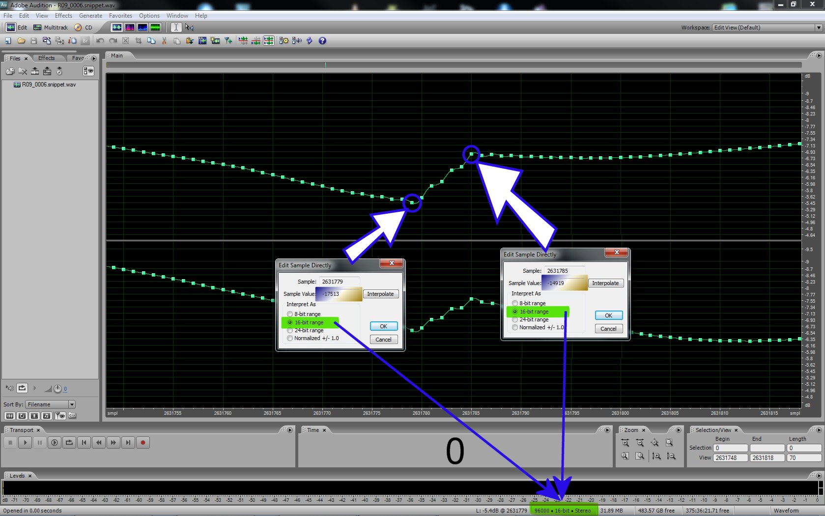

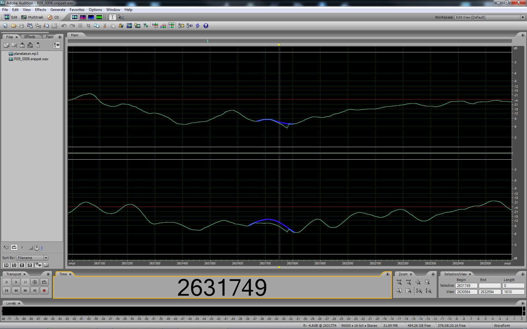

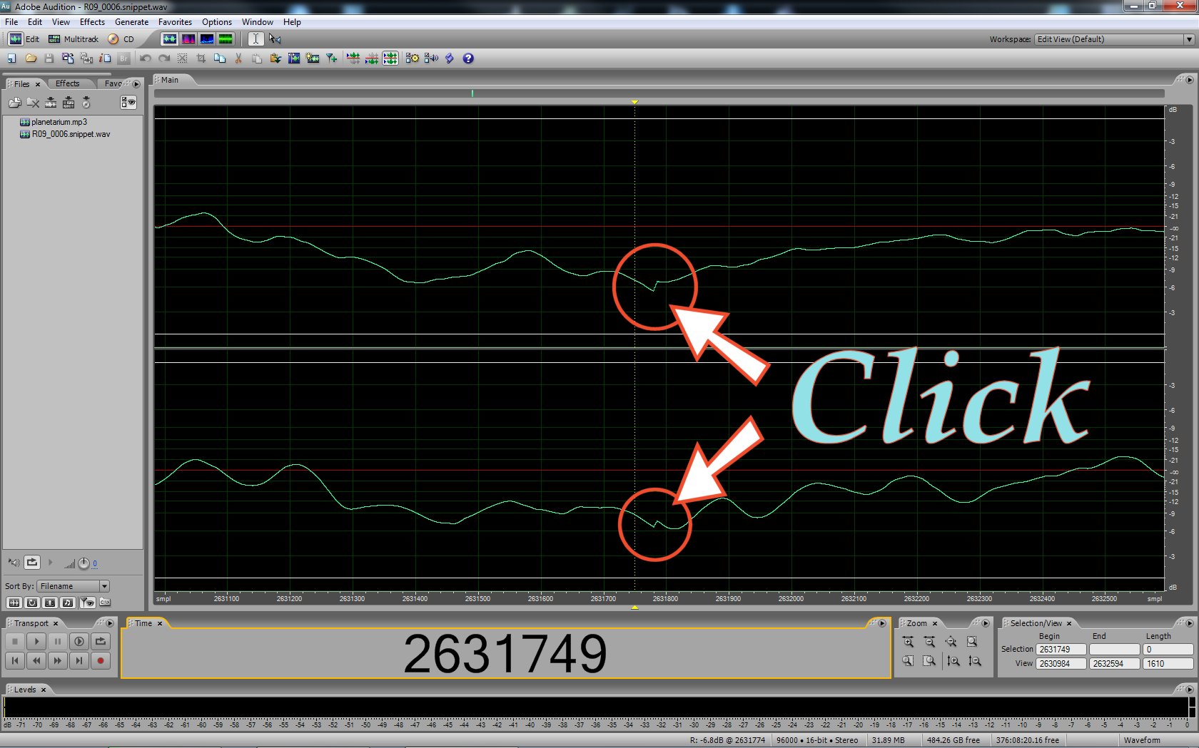

And here is a screen grab of a close-up of the waveform in question (the red arrow is where the first click happens in the sample I provided).
I hope that helps fill in some of the blanks.
I will have to experiment with my R-09 settings... Part of me wonders if the battery pack I have is to blame, or is this a clear cut case of "auto" settings ruining an audio capture?
I am hoping it is not a hardware problem. :(

Greg Miller January 25th, 2011 02:00 PM
Hi Paul,
Your questions are in line with my suspicions, which is why I want to see the original file.
In post #1, Micky said he had the recorder's "in line" power turned off.
In post #3, he said he was using an external battery module.
With a battery module, the mics themselves probably weren't clipping at the moderate levels one would encounter in a planetarium (lots lower than a live rock band, for example). And anyway, both mics would not clip at exactly the same time in every instance. But if he was running them into a mic input (rather than a line level input, as suggested in the instructions for that mic/module combo) then he might have overloaded the mic preamps. That would show up as some sort of anomaly in the waveform, but might have been much lower than 0dBFS depending on the configuration of the recorder.
It still strikes me as odd, though, because some of the clicks are *not* at program peaks.
For example, at about 28.707 there is a click with a level of about -5dB, but then after the click the level continues to increase to nearly -3dB without any further clipping.
Then at about 28.746 there is a click with a level of about -6dB.
So the clicks do not occur at a consistent level, and the waveform "voltage" sometimes increases after the time when the click occurs. Furthermore, the clicks occur at exactly the same *time* on both channels, even though the levels on the two channels are different. This isn't really what I'd expect if the electronics were clipping... I would expect that to happen at exactly the same *level*.
Yet the clicks occur at exactly the same time on both channels, each and every time. Could it be some sort of malfunction of the AGC circuitry in the recorder? Seems unlikely... the AGC circuitry should have some sort of reasonable attack time and should not generate audible clicks when it operates.

1.) An electret condenser mic is a type of transducer that converts audio energy to electrical energy. All mics have two terminals where the signal comes out. Professional mics, with a "balanced" electrical connection, have two signal terminals, plus a separate ground/shield. Consumer electret mics are "unbalanced" and one of the signal terminals is exactly the same terminal as the ground/shield. In addition, there is a "hot" terminal which does two things: it accepts DC voltage ("plug in power") coming from the recorder or from the battery box, and it supplies the audio signal back to the recorder.
Within certain limits, the signal voltage coming out of the mic is directly related to the acoustical energy going into the mic. More acoustical level produces more signal voltage. BUT there are some limits to this transfer function. For one thing, the physical reality of the mic limits the maximum physical excursion of the diaphragm. If, for example, the diaphragm can only move 0.01mm (which will be caused by some specific Sound Pressure Level) then a louder sound cannot move the diaphragm any farther than that. Another limiting factor is the DC voltage level being supplied to the mic (from the recorder or battery box). The mic output voltage cannot go any higher than the DC supply voltage (actually a bit less). So once the SPL reaches that level, the mic cannot produce any more output, even if the sound gets louder.
For most "plug in power" condenser mics, the physical limit of the mic will be higher than the electrical limit (which is related to the DC voltage). Thus, you see specs for your mic that say the maximum level it can reproduce is 105dB SPL when powered by a typical recorder (which probably provides somewhere between 1.5 volts and 3 or 4 volts DC, depending on the model recorder); or the mic can reproduce 120dB SPL when powered by the battery box which provides 9 volts DC. So when you're recording anything that might be fairly loud, you definitely should use the battery box. (The upper limit for most "plug in power" mics is around 9 volts... you probably won't find battery boxes that have a higher voltage than that.)
But now when the SPL gets loud, the voltage coming out of the mic can be pretty high... perhaps approaching 1 volt RMS. (I'm checking the specs for your specific mics.) That is too much level for most mic inputs to handle! That's why the mic's instructions say that you should always use the recorder's line input when using the battery box. And of course the line input does NOT have any "in line power" to worry about.
2.) Unless there's something really odd/bad about your present battery box, I don't think a different one would make the recordings any better.
(Actually there are some purists who say that re-wiring the mic capsules, and using a custom battery box with the positive terminal grounded, rather than the usual negative ground, will provide cleaner audio. That's way far beyond the options that are available to you. Forget I mentioned it.)
3.) I was not really suggesting that you might have had the "plug in power" turned on, at the same time as the battery box. But yet, you might have. (see #4 below) In that case, it's hard to predict what might have happened. The output voltage from the mic might have risen higher than the recorder's "plug in power" voltage. Now, both the battery box and the recorder should have resistors (at least 1k ohms, maybe as high as 10k ohms) between the DC supply and the mic connector. Those resistors should hopefully protect against damage in a situation like this. But even if there was no *damage* per se, perhaps having the recorder's "plug in power" and the battery box both connected at the same time, might cause some unexpected behavior... such as strange clicks. Perhaps we'll never know for certain.
4.) You see by now that this is in the nature of a scientific investigation. It's hard to draw conclusions without knowing all the conditions of the experiment. And you've been very openly uncertain about what you did when you made this recording. (Was the gain high or low? Was "plug in power" on or off? Etc.) Obviously since we don't know these things for certain, we may never know for certain what caused the problem. One lesson here is that you should always be sure how everything is set and connected, and hopefully make a few notes for later reference!
5.) Your file was 1,707,370,028 Bytes / 2964 seconds. That's 576,036 Bytes/second = 4,608,286 bits/second.
(96,000 samples/second) * (24 bits/sample) * (2 channels) = 4,608,000 bits/second
So yes, your original recording was 96kHz/24bits, as you originally recalled.
And that means that your previous "snip" operation did change the bit depth. So I definitely want to look at the original unchanged data, which hopefully you have sent today.

Distortion, of course, can take many forms. A very common form of distortion is clipping, caused when the signal amplitude is greater at some point than the signal chain can handle; the signal chain "runs out of headroom" for that signal.
In your demo file, we could call the "clicks" a type of distortion (although we could also call them a type of noise). We ultimately will try to inspect the waveform of your file visually, in order to determine whether the "clicks" are typical clipping or not. That might give us a clue as to how to avoid this problem in the future.
First let's have a quick demo of clipping.
Demo1-1.gif shows a few syllables of speech, without distortion (this is from a file I had handy). The top green waveform is the left channel; the bottom waveform is the right channel. I've marked a few reference levels (on the right channel only): 100% (0dB), and 50% (-6dB). Note, too, that I've highlighted a small portion in the second syllable.
Demo1-2.gif is the same file, but now I've zoomed in on the portion that was highlighted. Note that the peaks (the loudest levels in this part of the file) have a rather smooth, rounded shape.
Demo1-3.gif shows the same timeframe as the first image. Now, however, I have raised the gain by +6dB, so the signal amplitude is twice as loud. Compare the second syllable here (with the highlighted area) with the second syllable on the original image (Demo1-1.gif). Here, all the peaks stop at a level of 100%, because, by definition, the signal chain can not handle more than 100%.
Demo1-4.gif zooms in on the area highlighted in the previous image. This clearly shows an example of clipping. When the waveform reaches 100% (the thin horizontal gray line), it can't go any higher. So, although the peaks originally were rounded (Demo1-2.gif), they now become flat-topped. This is clipping.
Demo1-5.gif shows that you can't easily fix a clipped signal. Here I have taken the clipped signal from Demo1-4.gif, and lowered the gain by -6dB. Thus, most of the waveform is back to the original level. But compare the peaks here to the nice rounded peaks in Demo1-2.gif. Now they are flat-topped, even though their peak level is -6dB. That's because they were clipped previously (Demo1-4.gif) at 100%, and when we reduce the gain by -6dB (50%), they stay flat-topped but at a lower level. They are still clipped, and if you have a significant number of clipped peaks like these, the clipping will be quite audible.
In fact there is some software that will try to restore clipped peaks, and it will more or less work in some cases. It would probably work for the small amount of clipping in this demo. But that's beside the point for the sake of this discussion. The point of this demonstration is simply to show what a clipped waveform looks like.
In the next installment we'll take a look at your waveform and compare your audible clicks to this illustration of clipping.

Robert Wiejak February 6th, 2011 04:37 PM
2 Attachment(s)
Gentleman,
I will admit that I have not read the whole post, but I listen to your sample and found your ‘clicks’.
To me it looks like hardware, maybe power supply problem.
Take a look at the first picture and see where the click is in that waveform.
Attachment 21381
Then look at the second one and see if you agree that the waveform should look like the blue line in the second picture.
Attachment 21382
The whole ‘signal rise’ (the correction) in the first picture (the top waveform) is only over 7 samples @ 96Ksps, hence the click.
The difference over these 7 samples is 68dB.
I don’t have a solution for you, just thought I’ll share my findings. Interesting problem.
Greg Miller February 6th, 2011 07:57 PM
@Rob
Yes, that's the pattern that we're seeing. It is not always 7 samples, sometimes it seems to be as short as 3 samples.
I think you're way off. For example, in one "click" I analyzed, the "pre-click" sample value was 3959127, the "post-click" sample value was 3337707. Dividing those numbers gives a result of 0.843, which corresponds to a change of -1.48dB. If you expand whatever waveform display you're looking at, the vertical (amplitude) scale of the display will confirm that.
Cause still to be determined...
Robert Wiejak February 6th, 2011 09:37 PM
1 Attachment(s)
Attachment 21384
Funny thing about dB's, they are very misunderstood creatures.
dB is a ratios of two (one known, the other measured) quantities expressed in logarithmic units.
If you ware referring to full scale (the known value), compared to distorted samples (pre-click & post-click = measured value) then you are absolutely right, the difference is less than 1.5dBFS.
But I didn’t say full scale, I said ‘…the difference over these 7 samples…’ implying same as you pre-click & post-click:
-14919 - -17513 = 2594
Then to get the voltage ratio of the difference: 20 * log(2594) = 68.28dB
I hope this explains how I arrived at that number.
Remember, dB’s are not absolute numbers, they are always in reference to something.
Your numbers are in reference to full scale, my numbers are in reference to each other (pre-click vs. post-click).
Both results are correct.
Greg Miller February 7th, 2011 04:04 AM
Sorry, no, both results can't be correct, because 68 does not equal 1.5.
Funny thing is, I've been using dBs for 40 years, both in terms of circuit voltages, sample values, and in terms of antenna power. And I do understand the proper way to use dB.
When comparing two signals, you either divide the arithmetic sample values, or you subtract the dB values. The two operations, dividing the arithmetic values, or subtracting the dB values, are mathematically equivalent.
You're getting confused because you subtracted the two sample values, rather than dividing them to get their ratio.
As you correctly state,
dB is a ratios of two --<snip>-- quantities expressed in logarithmic units
dB always represents a ratio, which is then converted to a logarithmic scale.
Since your goal is to express how the second sample is related to the first sample, and express this relationship in dB, you need to start out with the ratio of the sample values. To get the ratio, you divide the two values. (Your mistake was that you did not find the ratio between the two values, because you did not divide them... you erroneously subtracted them. Subtracting does not give you a ratio.)
Then, as you state, you convert that ratio to a log, and multiply that log times 20.
The arithmetic sample values are absolute values. 3,959,127 and 3,337,707 are the actual value of those samples (converted from the binary data stored in the file). Full scale doesn't matter. Full scale could be any number bigger than 3,959,127. (Of course the actual value of "full scale" depends on the bit depth of the samples.) Regardless of what full scale is, those sample values are what they are.
In this case, to find the ratio of the two samples, you divide the second value by the first value, and you find that the second value is 84.3% of the first number. The log of 0.843 is -0.074. Multiply that by 20, and the result is -1.48dB. Therefore, the second sample is -1.48 lower than the first sample.
Don't take my word for it. (Apparently you do not.) You probably don't have the same books that I have in my reference library, so let's go to a readily available source: Wikipedia. Look up "decibel." Scroll down to the section titled "Field Intensities." (Note that the dB originally was used to measure power ratios, where the formula is 10*log(base10) of P1/P0.) Voltage, or in this case digital samples, is not a measure of power, it's a measure of intensity. So in this case the formula is 20*log(base10) of A1/A0.
Again, you did not divide A1/A0, you subtracted A1-A0. That does not conform to the correct formula, as shown above (from Wikipedia).
Let's look at it graphically. We'll use the file you posted. The "pre-click" sample you have circled is at -5.45dB on your software's scale. The "post-click" sample you have circled is at roughly -6.8dB. The second sample is about 1.35dB softer than the first sample. Incidentally, that's fairly close to the two samples that I analyzed... quite close, considering we analyzed two different samples at two different points in the file. In fact, the distortion mechanism here is quite consistent from one click to the next.
Another way to think about this: If our two "click" samples were 68dB different, that wouldn't be just a little glitch on the graph, it would be a huge jump. If the first sample was -5.45dB, the second sample would be -73.45dB. That wouldn't be just a slightly audible click, that would be a huge speaker excursion!
Look at it mathematically, look at it graphically to confirm it. Either way, the two samples differ by roughly 1.5dB, and that is not the same as 68dB. -68 is an entirely spurious number.
