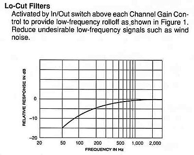

The trouble is, the FP-31, 32, 32a had steep HP filters around 150Hz, to the point that it would remove any 'body', thinning out the voice to excess. I cuss and spit on the ground recalling those dogs.

That actually explains why I thought it was a bit thin going thru my FP31. Do you know if it was improved in the FP33?

FP-33: "Down 6 dB at 150Hz. The roll-off slope is 6 dB per octave."
FP-32: Graphic from manual: Looks the same.
