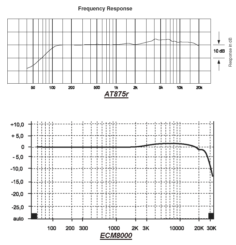

I have had a couple of weeks to try out the Behringer ECM8000, and I have to say that for $50 it does an admirable job. Compared to the AT875R I was using, the Behringer has a slightly more muffled sound, and high frequencies are not as crisp as the AT. But at 1/6th the price the Behringer is an excellent alternative.
I found the Behringer to be less sensitive. Now I know the term "sensitivity" may mean something significant to you audio experts out there, but in my limited knowledge I mean it to be how sensitive the meter reads when sound appears. In this instance the AT is much more sensitive to changes in audio levels, and the audio meter dances up and down way more than the meter that's reading the Behringer. In some ways that would make the Behringer a better choice for me, but when I compare the two I can't let go of the crisp high frequencies out of the AT, especially when the train air compressors let a blast of air out. That's where the AT shines.
But I have to say that neither of these mics, or for that matter ANY mic, is going to solve my problem. Because with my Panasonic HMC40, I can only guess at the best setting for any mic, and hope it doesn't get overloaded. Trying to turn down the little wheels on the XLR adapter would not only jolt the camera, but probably overload my brain functions and ruin the shot. Kinda like rubbing your tummy and patting your head. So is there any way I can buy some kind of machine/attachment/device that does record high quality sound, but also automatically adjusts gain to get good audio at a distance but compensate automatically as the train nears and the sound rises? Field mixer with auto gain perhaps?
I understand that to the purists what I am looking for is not real true audio. But for my needs I want the sound of the locomotives to be dominant throughout the whole shot. From approach, to pass and to receding. Thanks for all your help.

Hi Scott,
Glad to hear you're still "on track" with the project (pun intended).
Very interesting observations. You hear a "brighter" sound with the AT, and that corresponds to the difference in frequency response. Look at the two graphs attached, showing output level (vertical scale) versus frequency (horizontal scale). Notice that the vertical scale on the two graphs are not the same. The AT875 has a peak of around +4dB, from around 4kHz to 7kHz, while the ECM8000 has a peak of around +2dB and a much smoother peak at that. So yes, the AT probably sounds brighter. Also, the AT has less output at the very low end, which shifts the frequency balance higher... again sounding a bit crisper.
What you call "sensitivity" is not quite the usual definition. However, I understand what you're saying. I can only offer some guesses here. The AT is very directional so it is picking up different sounds as the train goes past; the Behringer is omni so the sound it picks up does not change as much when the train passes. Also, lower frequencies tend to be more constant in level (over a short time); higher frequencies bounce around more, and the AT is slightly more sensitive to high frequencies. All this could explain why you see the levels bouncing around more with the AT.
Certainly you can buy a separate audio recorder, with good metering, switchable AGC, and switchable peak limiting. You will need one that supplies at least +11v phantom power to the mic, so that will elminate some of the less expensive recorders. Zoom makes a few which seem to be well regarded, the H4n (which even has a nice stereo pair of mics built in) is around $300; there are others upward from there.
I would advise against using AGC, as it will try to make the level uniform. That will sound unrealistic, as the train is much quieter when it's 100 yards away than when it goes past 50 feet away. I have heard some bad train recordings where the whistle blows causing the AGC to lower the gain significantly. As a result, while the whistle is blowing the sound of he engine becomes extremely quiet; when the whistle stops you can hear the AGC quickly "turn up the level" of the engine. VERY unrealistic.
I would suggest you set your level when the train is at its loudest... the nearest distance and with the whistle blowing. Adjust gain so you are recording at around -6dB. Then don't touch the gain control after that. You could also turn on peak limiting (if available) and that will protect you from clipping if the sound increases unexpectedly. (Peak limiting is quite different from AGC.)
Perhaps some other folks will jump in here with recommendations for specific recorders.
Meanwhile, if you do get an H4n, please do try recording in stereo... just use the integral mics... and see if that doesn't sound much more realistic than a mono recording does.
Thanks for the update, and please keep us posted!

I notice the two single-mic recordings have a fair amount of level fluctuation... presumably caused by multiple engines going past, or by your panning the mics. The Sanyo recording has very constant level, so I would guess that recorder has a lot of internal AGC, which will tend to make the recording un-realistic.
The response of the two single mics is as expected, based on the published curves. The Sanyo has more midrange and HF information (from about 500Hz to 6kHz), compared to the two real mics. I would guess its response curve is tailored to improve speech intelligibility. But again, this deviation from flat response will make for a less realistic recording.
