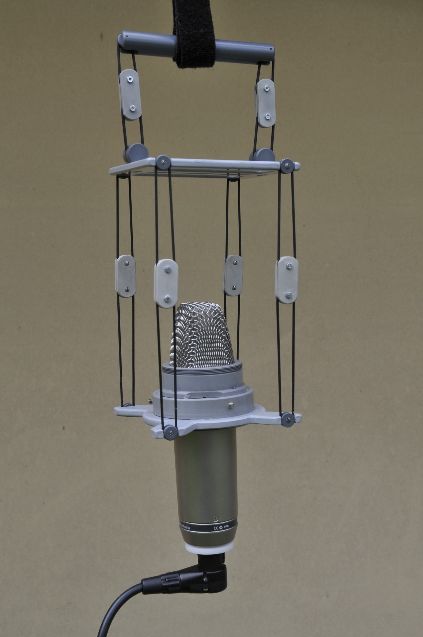

This was a big step in the right direction, even though it is classed as a studio mic I was assured it could be adapted to field use. I have a versatile mechanical workshop and I have spent some time trying various adaptations. Initially I tried hand holding it in the supplied mount but soon found the handling noise was very obvious. Next I fitted it to a Rode blimp, again the handling noise was very obvious and I also found that using a side entry mic in the blimp was very uncomfortable.

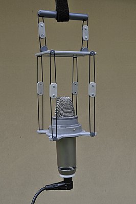

I then tried a larger home made blimp in which I could use longer “O” rings than could be fitted to the Rode blimp - again the same problem with handling noise. The current version is made a bit like a puppeteer’s marionette with the mic suspended on “O” rings from a handle that I can use to control tilt up or tilt down. It is also easy to suspend from a tree. Handling noise at full gain was initially a problem but I finally discovered that it is not the length of “O” rings that is important but the number of “O” rings in the chain. I have found that if I connect “O” rings to one another using plastic connectors the handling noise drops appreciably with each interconnection, i.e. it is the impedance mis-match that is important. So after a bit of evolution as distinct from “intelligent design” I can now run my NT1-A and SD702 at full gain (if conditions are quiet enough). With it I can hear noises that I cannot hear otherwise. I once inadvertently directed it towards my body and was amazed at the noises emanating from my gut.

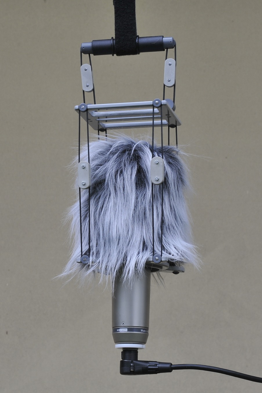

The design is not ideal as it does not take much wind can generate noise in “O” ring suspension but as noted above I chose calm weather conditions. However the design is more compact than the conventional blimp design and that makes storage easier.

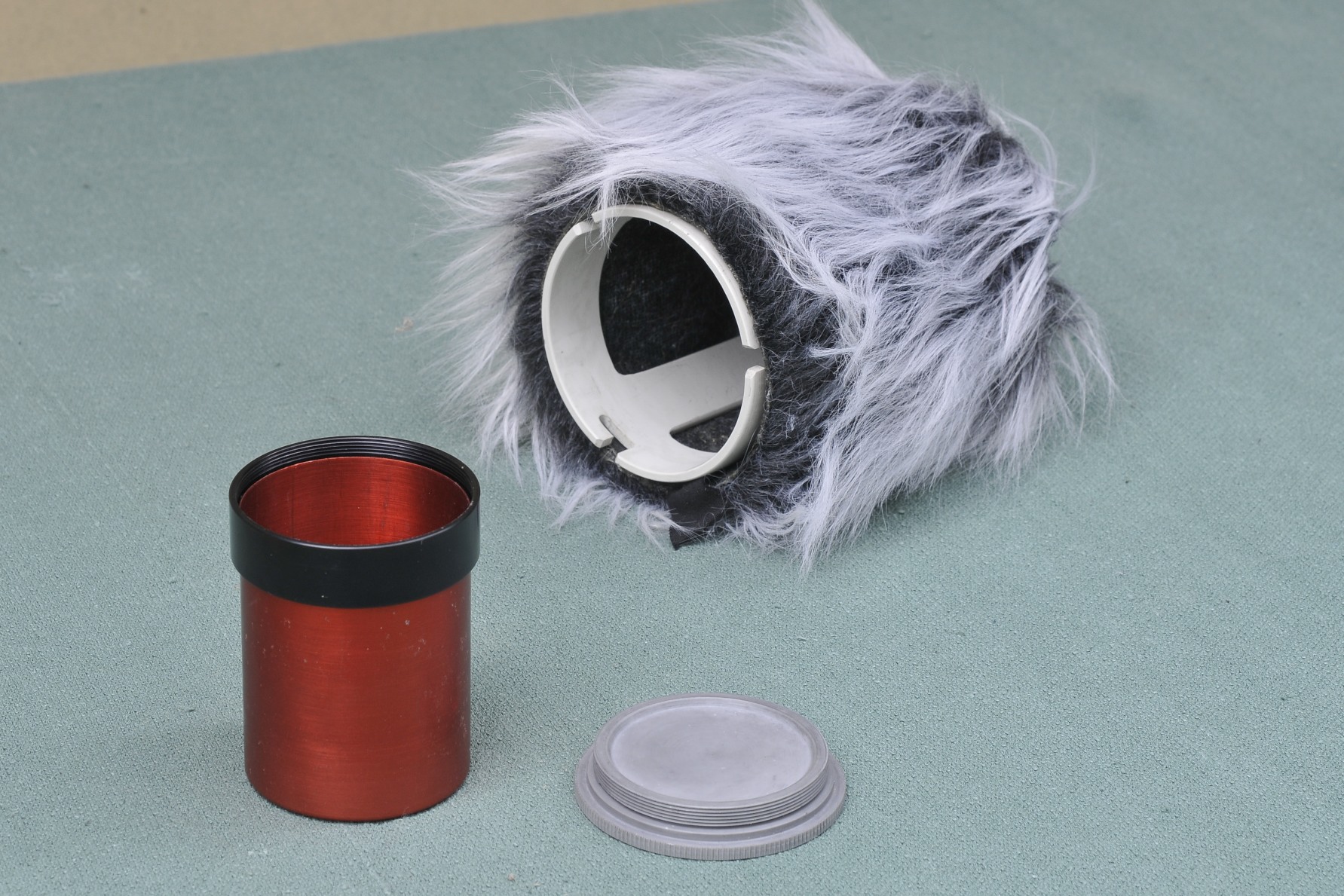

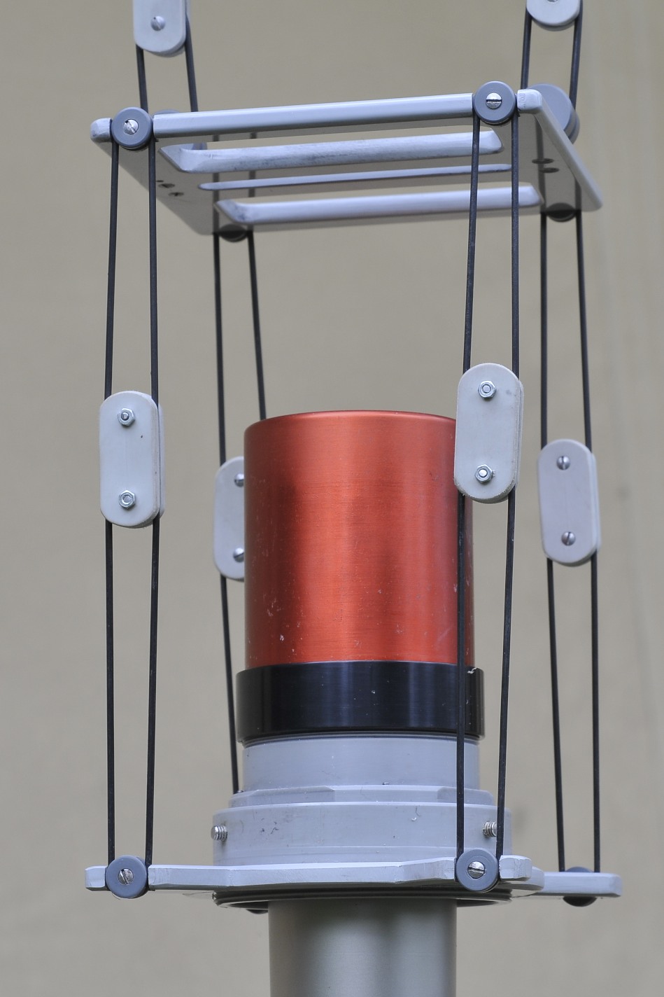

A potential problem with the NT-1A and other studio type mics is the effect of humidity on the diaphragm. Although I have not noticed any adverse effects of humidity I made provision to store the mic with silica gel. The red container in the photograph contains silica gel behind a perforated screen. The container can be screwed to the mount where it covers the mic capsule. When the mic is in use the red canister is removed and sealed by a screwed plug. Periodically I heat the silica gel to remove absorbed moisture.

Interesting DIY solution! Without seeing this setup in use, it seems like the mic would swing around a lot when you move it. I'm guessing that once you have it set up, there's not much movement involved.

Hi Andy,
Is there a commercial solution?
As mentioned I tried both the Rode Blimp and the supplied Rode NT1-A mount but the handling noise was terrible at high gain. The Rode products are well-made and I assumed that they were not much different from other products designed to do the same job. The problem was that I was asking for too much.
In practice the swaying is not a problem as I have to be as quiet as possible and this means keeping as still as possible.
