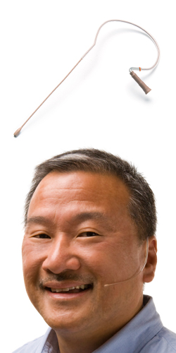

The Countryman E6 an E6i has become almost an industry standard. We've put quite a few of these into houses of worship and have used this model in a lot of our podcasts. Very light. It used to be my fav until I heard the Da Cappo. Get the "i" model if various talent will be using it. If not fit correctly, or bumped, these can cause repositioning issues. I do love how fast that you can put them on and how malleable the "i" version is. Countryman also offers the best choices for skin colors, tan, light beige, cocoa and black. In the $350 range - very well priced.
E6i Omni Earset Mic - Countryman Associates, Inc.
