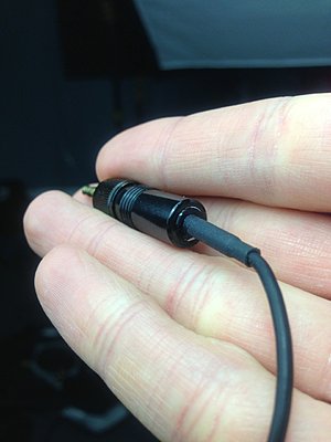

Tough gigs if you're snapping connectors! I know that you also had the transmitter pouches too, did those not work out? On the inexpensive side, I would get some heat shrink tubing and put it on the Micon connection. That would put less strain on the connector and save some cash. I'll also let the folks at RODE know about the issue and see if they can toughen up the design and drop 3 replacements in the mail.

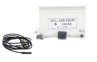

As I said earlier in the thread, we buy packs of 10 COS11-D lavs in pigtail, then wire them for Lectro, Sennheiser, Shure etc. The 3.5mm locking connector we use is plastic and has been holding up well. We have sold well over 100 units and have not had any fail. The Sennheiser MZA-900P XLR adapter works perfectly, just try to use the clip to relieve some of the strain on the connection. We do have a bundle of the two that we offer Sanken COS11-D lavalier with Sennheiser XLR adapter Audio Here are a couple of quick pictures of the 3.5mm locking connector and the Sanken COS11-D.
Sanken COS-11D on the Sennheiser G2/G3 systems-_57.jpg   Sanken COS-11D on the Sennheiser G2/G3 systems-sankencos11mza900p__24539.1307984818.1280.1280.jpg

The Sanken COS-11D is available in 1.8 or 3.0 meter lengths. We carry the longer version, which is about 6.5'. Sennheiser uses metal locking collars. We use a 3.5mm plastic locking collar with a black chrome metal threading body (similar to the Tecnec unit in the post above). We also heat shrink the strain relief for added protection.
Sanken COS-11D on the Sennheiser G2/G3 systems-img_0961.jpg

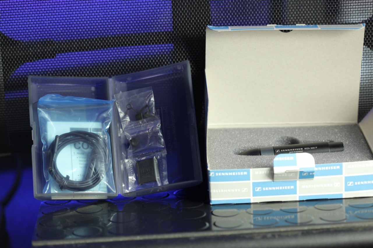

Thanks Guy. I just placed an order with you for that MZA kit.
I just shrink wrapped my rode video mic cables (over some gorilla tape for good measure), and discovered that it's probably best to only do that on one end (the transmitter end). Adding the shrink wrap to the mic end makes that end too unwieldly and likely to cause rustle when hidden on an actor. So I'll probably carefully cut it off on that end and just leave on the transmitter end. Good idea.
