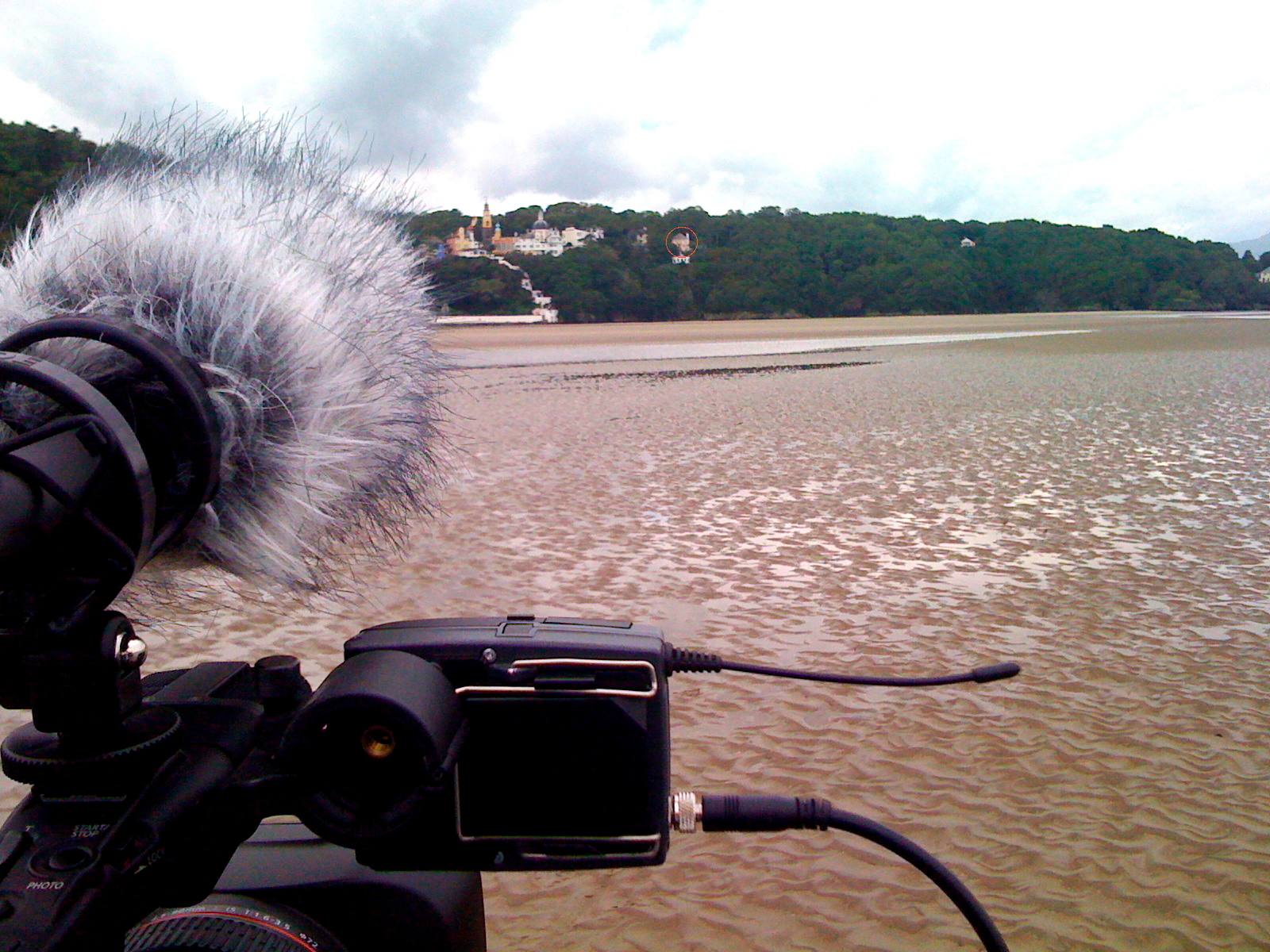

Even the G2 had an astonishing range. Here's a photo of a line of sight test I did a couple of years ago, using a G2 set to catch the merry sounds of day visitors at a viewpoint.
The transmitter is outside on the balcony of the building with the little red circle round it in the full size image. The distance involved was at least 800m and the signal was rock steady provided the alignment was kept (it began to break up it the camera rig was panned more than 45 degrees but on a repeat test with more sensible vertical aerials, it didn't break up at all).
Looks like Portmerion to me - were you doing a re-make of "The Prisoner"?
