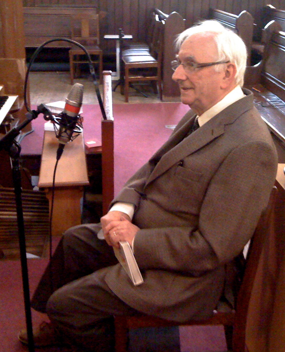

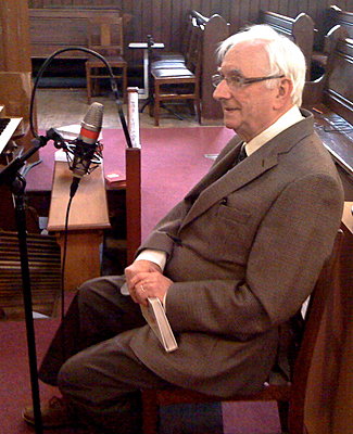

The large condenser/popshield setup is very common in studios but it might not be the look you are after. To give you an idea what it looks like, here's a quick iPhone photo of a "young boy" I recorded (just the audio) using that setup:

Thanks Steve and Colin for your replies. Great shot of the Rode NT1A in front of that handsome lad who no doubt has a deep sonorous Glaswegian voice.
