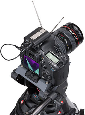

I'm also kicking around a new lightweight UHF wireless from Samson. Samson AirLine Micro Camera - Wireless System - DVeStore The only real bummer is that it is single channel (not frequency agile with 1600+ selectable frequencies like the G3). Basically when you purchase you pick N1 - N6. The transmitter and receiver are the size of a box of a matches! Dang these things are light too - even with the built-in lithium ion batteries - and at $299, you could get two sets for the price of G3.
Are the batteries removable, or is it just time to stop shooting after 6 hours?

Battery is internal and non-removable on the Samson Airline Micro wireless system. User manual states ~10 hour battery life.
There is a DC IN USB port on the bottom.
The manual says that you can use a computer to charge the unit or a cell phone charger. It does say that AC power using the included charger would charge faster than a computer.
I'm guessing that you could also use one of these optional external battery packs out in the field
If I plug the included AC charger into the Xmitter while it is on, it does indeed power off the unit. And ouch, make sure you headphones are off - you get a blast of static when the Receiver loses the Xmitter. No pilot tone argghhh.
Note that the Samson wireless does include both miniplug cable and miniplug to XLR, which tells me that they may be aiming these at higher level cameras than just the consumer models. I'm not totally sold on 'em for a pro project other than the size may be a crucial factor for certain shoots.The Sony or the Sennheiser still get my vote.

Arrived yesterday. Can't remember a time where I was so impressed with a product's form and packaging, even Apple can't outdo these guys. The USB charging thing is really slick, can charge from wall outlet or car, or laptop computer on the go. Both TX and RX are about the size of an iPod nano. The included mic is tiny, much smaller than a ECM 44B - it came with extra windscreens (which is good, I am notorious for losing them). The included case is of good quality, and really well designed with a zipper pocket to keep all those easy-to-lose-hard-to-find pieces in one place, and a separate pocket to keep the instruction manual handy.
Of course, the true test is sound quality and distance, neither of which I can attest to at this point.

The thing is a total piece of junk, it won't hold a signal longer than about 30 seconds or farther than about 10 feet. Suffice to say I would not repeat.
