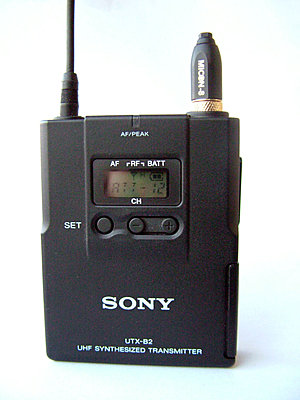

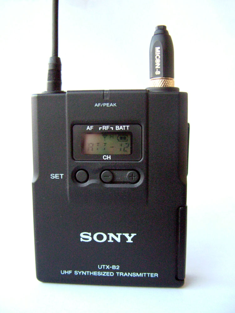

When I first used the PinMic with a Sony wireless kit (replacing their lav mic) it was connected with a Micon 2 adapter which gives you a straight 3.5mm jack.
I found that the signal coming out of it was very low compared to the Sony lav, and to the point that the auto-level circuitry on the camera was maxed out and I could hear the background noise from the FM transmission quite noticeably.

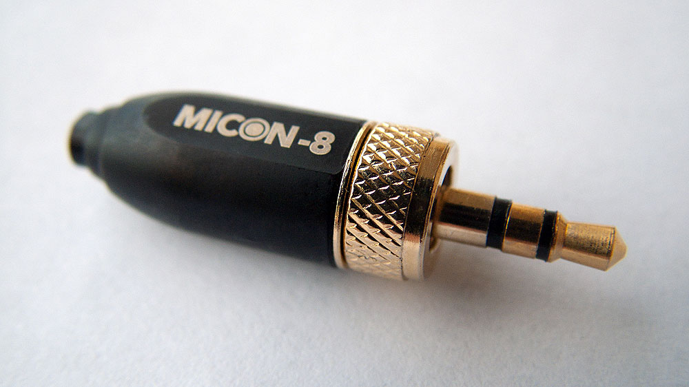

I called the tech support at Rode and one of the first things we established was that the signal loss was about 12dB ... which would suggest an issue with balanced audio being fed to non-balanced audio. I also found out that they have since released another adapter specifically made for attaching to the Sony lav mic kit and handling this better ... the Micon 8. (this new connector was not available when I purchased the pin mic) You will note that the Micon 8 has a tightening screw ring thinggy (technical term) just like the connector that the Sony lav mic has.
Haven't had a chance to use it yet and enjoy confirming the fix, but hoping that this will solve the issue for anyone else who may be stuck. As always, the support from Rode has been fantastic.
Andrew

I am curious about the technical aspects of how one connector could provide a 12db greater signal than another. The mic is unbalanced and wireless receivers are unbalanced, so I doubt that is the issue.
The other day I compared levels with three mics I own, and determined that on my g3 system:
The ME2 omni mic gives about a 3dB hotter signal than the Rode Lavalier with Micon1.
The ME4 cardioid mic gives about a 10dB hotter signal than the Rode Lavalier with Micon1.
So I'm wondering if this Micon8 connector would give me a hotter signal with my Sennheiser g3. The Rode page says the Micon8 is only for Sony, but why oh why? I would think that both connectors would simply wire the ground and signal-with-plugin-power together with no passives.

There is a wide variety of different connection schemes used by various makers of wireless transmitters. If the microphone is not wired properly for the particular make and model, it will have poor (or even no) performance. There is significant circuitry inside those Micon adapters, they aren't just mechanical contraptions.
Note that mechanically, the Micon-3, Micon-6, and Micon-7 appear identical. But they are NOT interchangeable because of the circuitry, and that is why they are separate models. And the Micon-1, Micon-2 and Micon-8 may appear physically similar, but they are NOT interchangeable, either.
There is also a variation between the sensitivity of various lav mic designs, so it doesn't seem surprising that you see a difference between different makes and even models. I would NOT recommend blindly substituting a Micon-8 to use with your Sennheiser transmitter. It seems highly unlikely to achieve your desired result, and has a significant risk of damaging the microphone and or the transmitter.
Agreed that balanced vs. unbalanced is NOT the problem here as all lav mics are unbalanced, and all wireless transmitters are unbalanced as well. But various manufacturers use different pinouts and parameters for their mic inputs, and the microphones must comply to the different interface standards. It wouldn't surprise me to see Rode come out with even more Micon adapters to keep everyone happy.

Actually, audio impedance is typically NOT the issue here. It is more likely the supply voltage/current of the transmitter vs. what the microphone needs, which affects the power coupling resistor value, and, of course, the pinout, or which pins are assigned to which functions. Alas, there was never any industry standard consensus on this as there is for conventional 3-pin XLR, for example.
