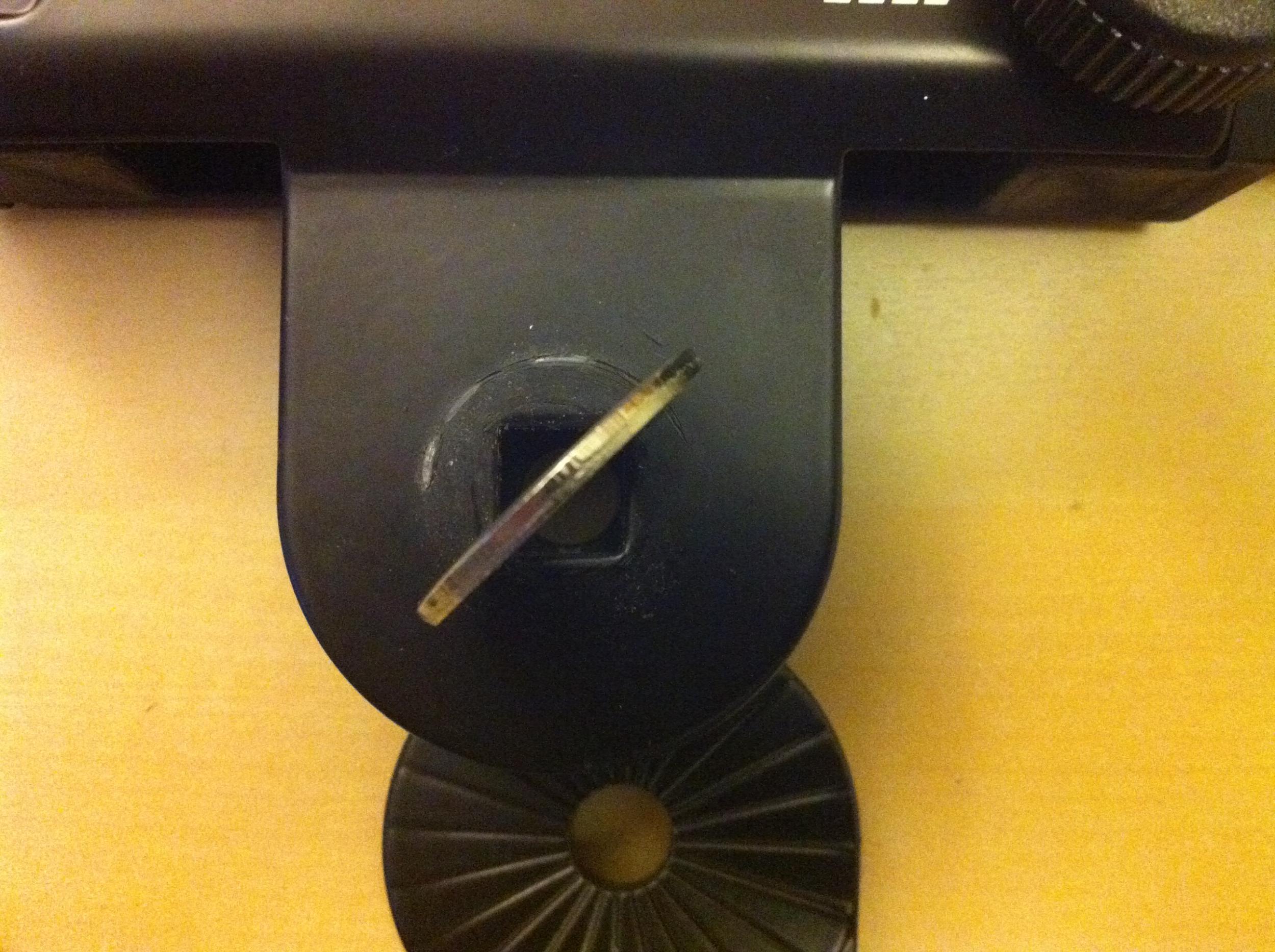

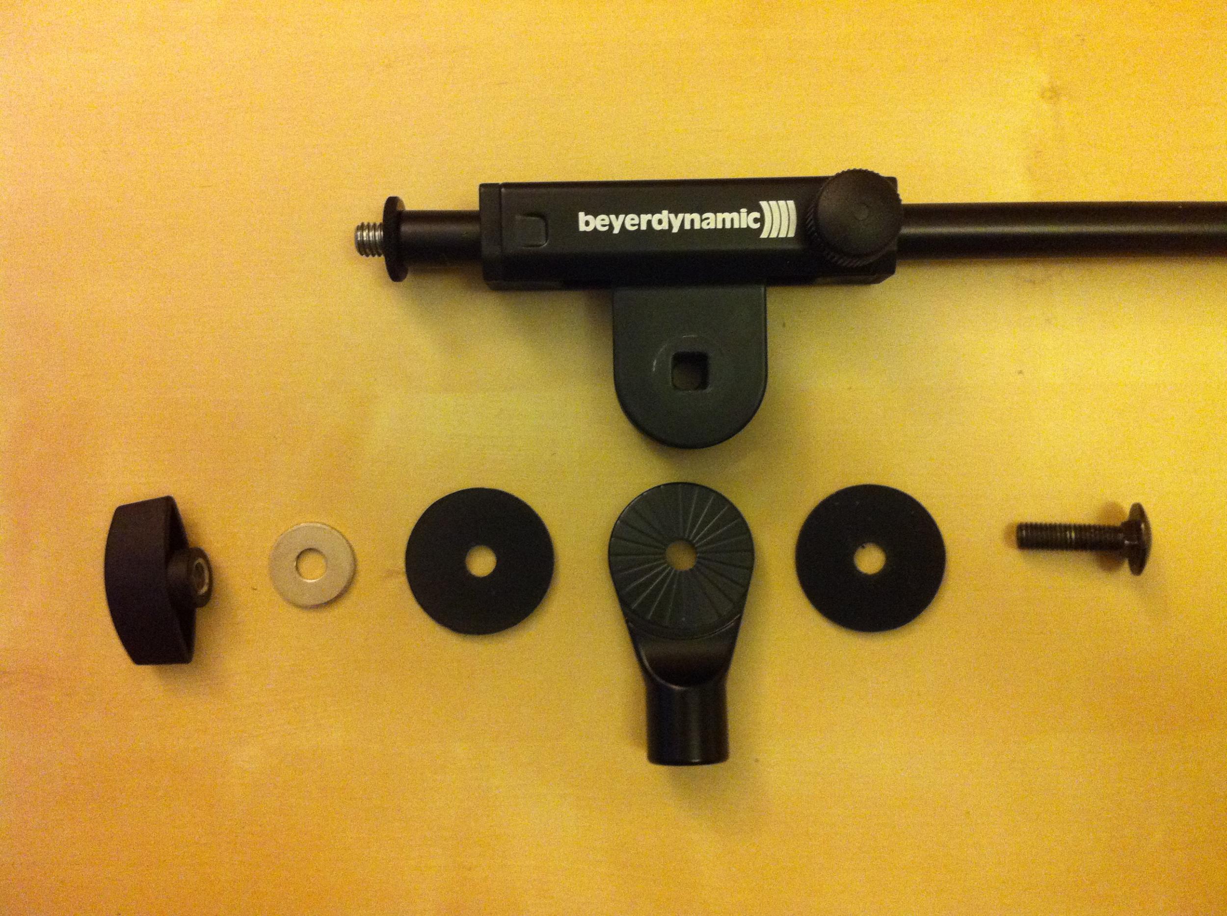

The cupped washer under the tightening nut was installed facing the wrong way
Jay, if it's the same model as mine, the washer IS flat.
(Apologies for iPhone photos)
EDIT: Now that I look at the box, mine are Beyerdynamic GST400 but the difference is mine have a fixed length rather than an telescopic boom arm.
http://europe.beyerdynamic.com/shop/...t-400-3-8.html
http://europe.beyerdynamic.com/shop/...t-500-3-8.html
sturdy, portable mic stand/boom arm?-nuts.jpg   sturdy, portable mic stand/boom arm?-nodome.jpg

Colin, it is more subtle on yours than on older stands, but I believe the way your washer was stamped does make it not exactly flat, especially around the edge.
It's something worth checking even from the factory, along with removing any grease that may be on any of the components that need friction to hold tight.
