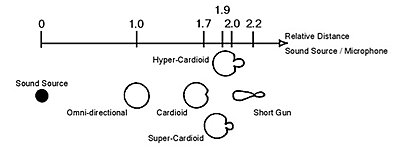

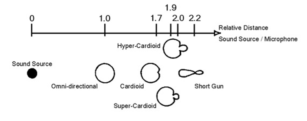

Old January 28th, 2012, 06:09 AM   #13
Join Date: Oct 2008
Location: Oxfordshire, UK
Posts: 976
Re: Camera mounted mic
Originally Posted by Steve House View Post
Every time the operator looks at a different part of the scene his head would turn and the mic would shift, taking the subject off-mic.
Yes - I have seen this on the TV many times when a piece is shot by unprofessional people. The reporter is talking and the camera pans away to what he/she is talking about and the dialogge goes completely as the mic. is now pointing elsewhere.
Also, it is a myth that shotguns let you work as far away from the subject as one would normally have the camera operator standing. They do not. While their suppression of off-axis noise lets one boost the gain s tad and thus work a little farther away, they do not magnify distant sounds at all. For proper dialog recording even a shotgun needs to be no more than about 18-22 inches away from the talent. The quality begins to drop off as soon as you get farther out than that. Unless you put a lav on the talent, getting the mic close enough to the talent for optimal pickup usually means a boom and that in turn usually means someone to operate it. It's not a matter of operator preference, one needs to let the laws of physics that govern the setup necessary to get the desired results to dictate one's working style.
A short gun mic. at 22cm picks up the same sound as a cardioid at 17cm or an omni at 10cm - so a gun mic. just doubles the distance that you would use for an omni mic.
Not a lot of people realise this - unfortunately.
John Willett - Sound-Link ProAudio and Circle Sound Services
President: Fédération Internationale des Chasseurs de Sons
John Willett is offline   Reply With Quote
Old January 28th, 2012, 10:06 AM   #14
Join Date: Jan 2011
Location: Pennsylvania
Posts: 1,796
John:
That's a great chart!
For clarification, when you say "picks up the same sound" are you talking about sensitivity (or gain) in the forward direction? (Without regard to off-axis rejection.)
I would think the ratio of on-axis to off-axis pickup would be much more complex, depending on the frequency and direction of the off-axis source.
