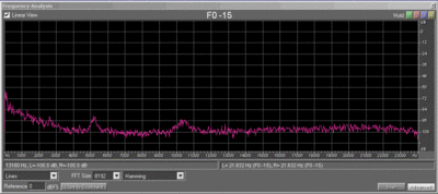

I downloaded it and opened it in Cool Edit Pro. It is clearly an audio file, two channels, 48kHz sample rate, average peaks around -54dBFS, occasional peaks ~ 3dB higher than that.
I hear the room, and I hear a HF "birdie" wandering around the range from ~ 5kHz to ~ 6kHz, and it seems to have a harmonic an octave higher. You can even see a bit of the birdie here, on CEP's Frequency Analysis tool.
I feel pretty sure it's some sort of RF problem, but can't speculate as to the source. RF getting back into the audio, perhaps? It would be very hard to filter out of the received audio, because the frequency is very unstable. Is there anything else you can isolate? Unplug? Turn on/off?
(BTW, I can play the downloaded file just fine on Windoze Media Player... no problem whatsoever.)

Well, I think your best bet is process of elimination.
Do you have anything else plugged into the other input of the recorder? If so, unplug it.
Are you sure the mic cable is OK? Shielding OK?
Try the mic with a different recorder/mixer.
Try a different phantom mic with the existing recorder. Turn off the phantom power and try a dynamic mic. (Remember, this mic is a bit of an oddball, it uses RF demodulation to get the audio from the capsule, rather than DC bias voltage and a hi-z preamp.)
Try the recorder on AC power. (Maybe the phantom power supply in the recorder is acting up.)
Is the recorder's monitor level set extremely high? Possibly some coupling from the output to the input, from headphone cable to mic cable, etc.?
IMHO there's no good way to eliminate this noise in post, because there are at least two harmonics, and the frequency moves around quite a lot. Having voice "cover it" is not a solution. Downward expansion would drastically effect room tone, so that's not a good choice either.
Let us know how you make out with some substitution tests. Good luck!

I was finally able to hear it. I normalized the wav you posted in Soundtrack Pro and played on the good speakers. Kind of sounds like some of the noise you can get from a computer system or something with a bad capacitor. Doesn't sound to me so much like RF noise.
