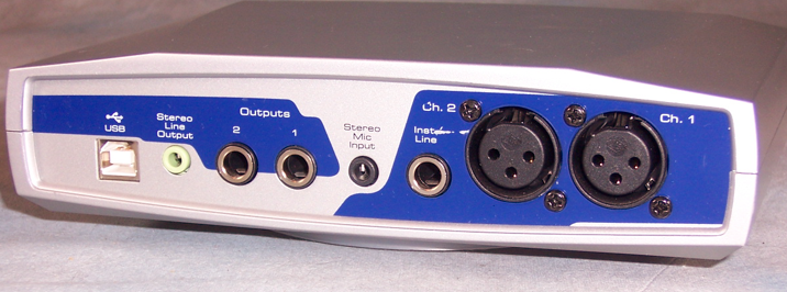

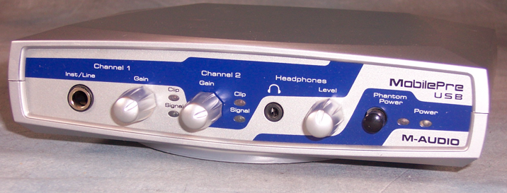

Here are a couple pictures:
How much applause to retain in recording?-screen-shot-2012-08-29-9.44.24-pm.png   How much applause to retain in recording?-screen-shot-2012-08-29-9.44.46-pm.png

"You're using a Mobile Pre, so that requires a computer to actually record. I have no idea what the Mobile Pre offers in terms of outputs, so your mileage might vary with the procedure I outlined above."
Obviously, you have a USB out to the computer. You also have what looks like 1/4" stereo outputs, though I can't tell if those are balanced or not and what kind of levels they output -- line or microphone -- (and M-audio's website doesn't say). In the end, it may not matter: it sounds like your computer situation is not optimum, and fussing around with a laptop and software that may or may not work would be reason enough (for me) to completely forget the setup and just get a dedicated audio recorder and be done with it. Your money, however... ;)
