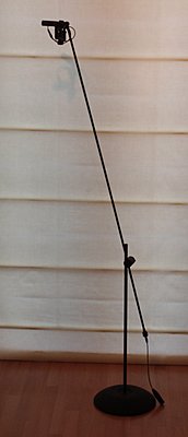

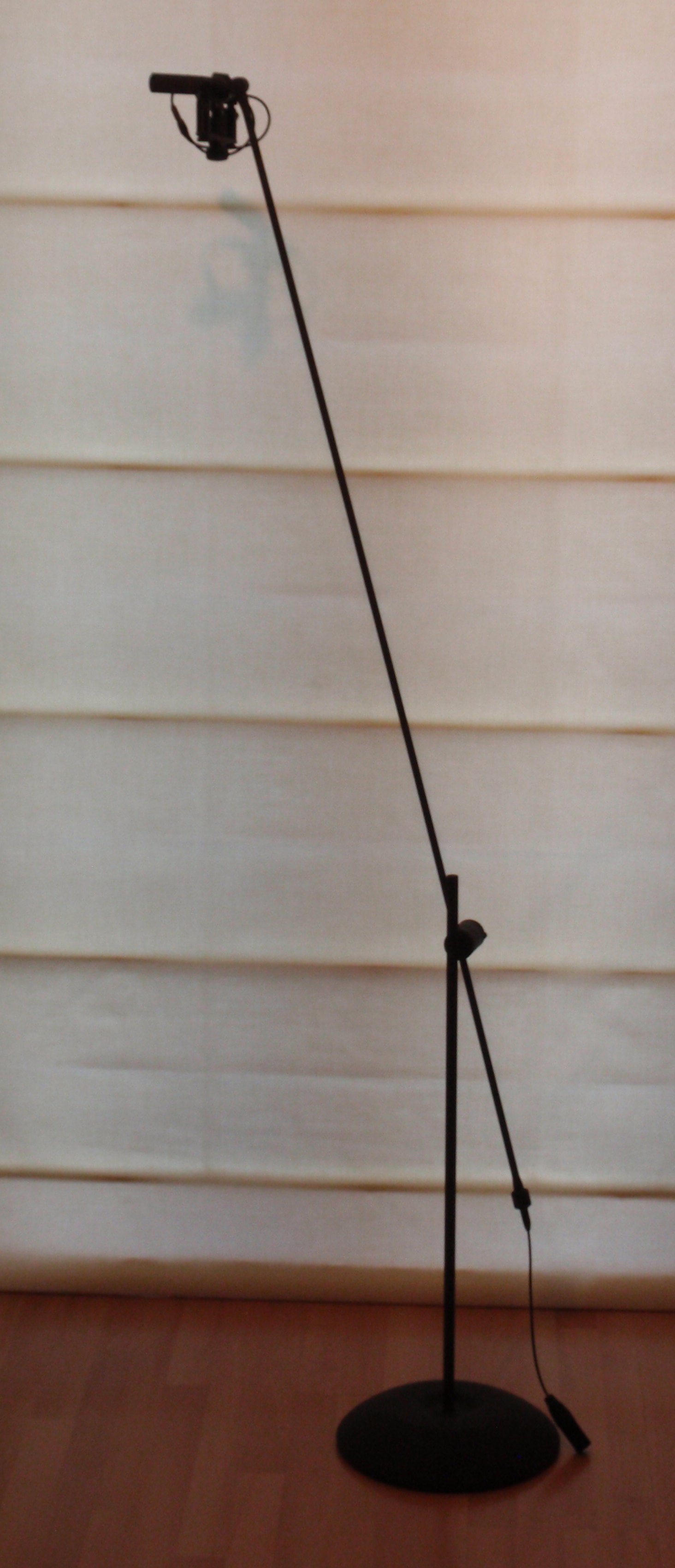

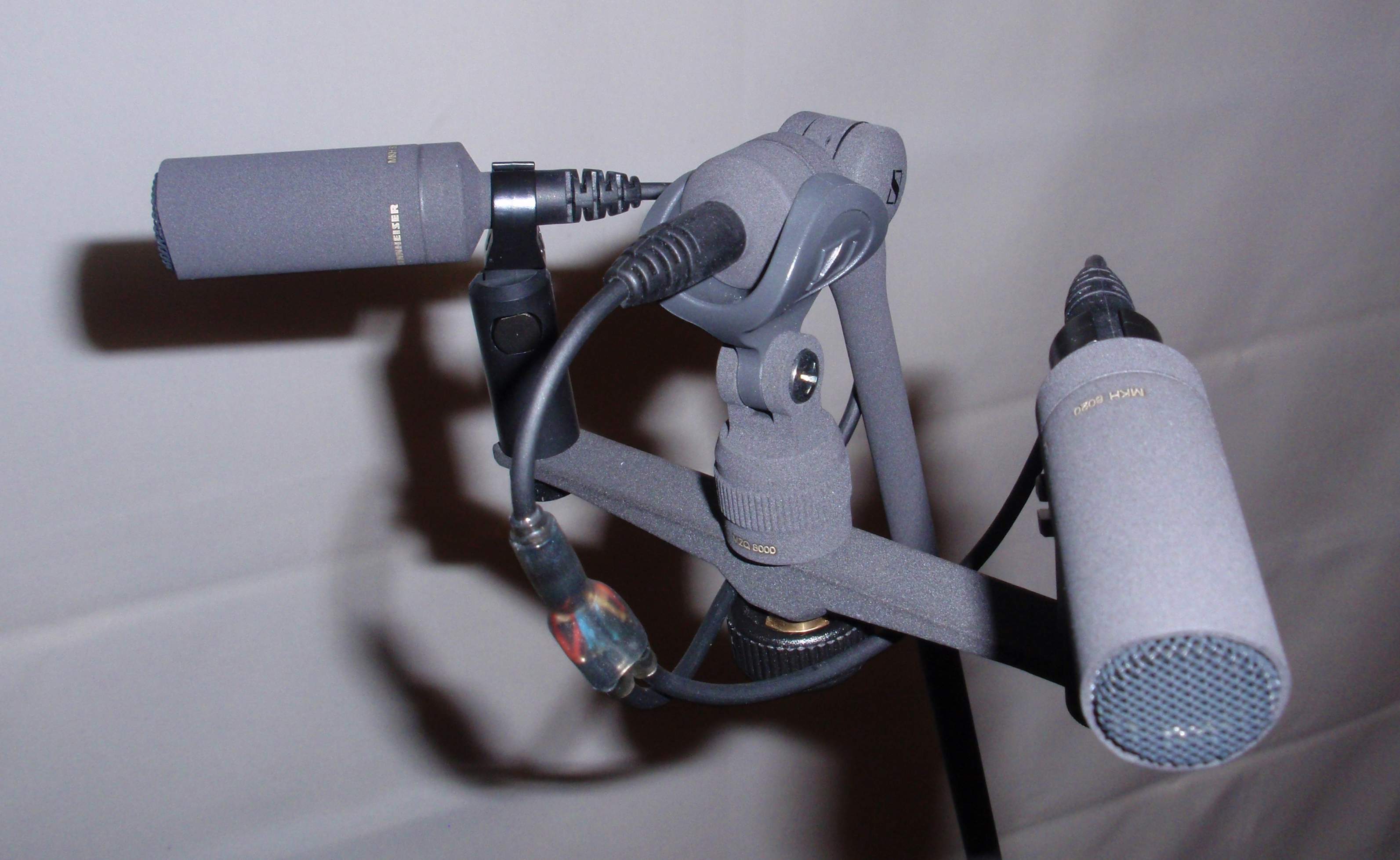

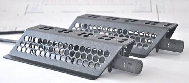

This is my speciality.
A grand piano normally needs omni mics or you lose the bottom octave.
My starting position is a pair of omnis about 20cm apart at about ear height about 2 metres from the piano.
I will then adjust to suit the piano, the work and the room.
You can normally have mics in shot when videoing a grand as the sound is so important. Where the mics are in view (eg: video or a live concert) I would use a pair of Sennheiser MHK 8020 heads on a custom stereo bar on a Sennheiser thin stand - this goes virtually invisible at a concert and is unobtrusive on video.
This is the mics on the stand
This is a close-up of the mics.

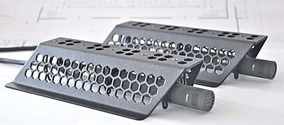

For recording without video I would use the Gefell M221, Sennheiser MKH 20 or 8020, or Neumann KM 131-D.
If the mics *have* to be invisible, then boundary mics are the best - either a couple of DPA 4060 or Sennheiser MKE 1 or 2 stuck to the inside of the lid or a pair of omni SDC mics in a Turtle underneath the piano. Both these work well.
An upright needs a different technique - normally away from a wall and microphones behind the piano - this way you can get good video and good sound without seeing the microphones.
I hope this helps.

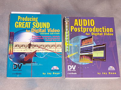

If you think that's where you're at, then I suggest you start by reading a few good books. I've never seen any "Dummies" audio books (although I've never looked).
However, Jay Rose has written some excellent books which can be comprehended by beginners, yet have some fairly advanced content. At one time, I believe, they could be found on Amazon. If not there, try Google. (If you still don't find them, let me know, I should have contact info for Jay.) Of course technology evolves fast, so any print book might not cover the very latest models of equipment. But the basic concepts are there, and are explained well.

I too recommend Jay Rose's books, he does a great job with them and the included CDs.

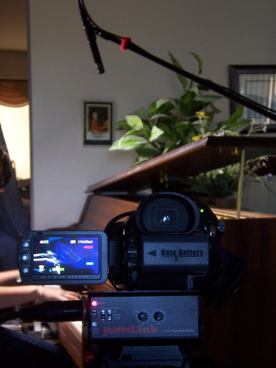

Bingo! Thanks John, this is the kind of thing that is really helpful. After reading your post yesterday I went and got my gear set up on the upright then called for the talent to play me some numbers. I did over a dozen takes using various setting combinations then went to examine them using Final Cut Pro X.
After reviewing the takes I deleted five of them right off then started examining the rest. There were two main variables and they were both the two gain controls on the JuicedLink pre. It has a Low, Medium, and High gain setting slider switch and a gain control knob. I adjusted both of these but, unfortunately, didn't write down when I used the switch settings.
Reviewing the takes showed areas where there was distortion that was both audible and visible on the FCPX VU meter. This morning I went back and did a new setup and some more takes. This time, though, I tilted the top of the piano up so the mic could hear the treble strings better. In the picture it looks like the mic is pointed toward the bass side but it isn't, it's pointed toward the treble side.
Once I get it edited I'd like to post a video clip here but I don't think the audio would play that well.

Thanks very much for all your input. Oh, and that's the ME-64 on the boom.
I've got two of his books and one even has a bookmark in it when I took the picture.
One nice thing about physics is it doesn't tend to change much. Technique and technology is not so static.
