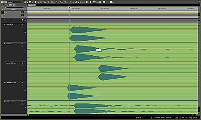

I know that perfect sync is impossible on these small recorders but would you say that in a 50 minute continuous recording a drift of 1 frame is also unusual because that's what I"m getting on most of my recorders, I did a test with my Sony cx730 and my audio recorders (that all recorded in the mp3 format), made a clapping sound at the beginning and end.
I checked in Edius and there you only can zoom in on frame level but this is what I can see after 50 minutes of recording:
Iriver: 1 frame out of sync
Yamaha c24: about 75% of one frame out of sync
Zoom h1: 1 frame out of sync
Yamaha dr40: 9,5 frames out of sync
To my surprise my brandnew dr40 was most out of sync, wonder if recording a wav file (instead of a mp3) would make any difference, will test this as well in a few days)
You can see the names of each recorder on the left side (it says wav behind each recorders name but that was because I had converted to a wav file a s well to see if that made a difference but it was the same) The top wave file is from my Sony cx730.

I just used audacity to see how many milliseconds it was because there I could see more in detail:
After 49min45sec recording out of sync
Iriver: 28 milliseconds
Tascam dr40: 199 milliseconds
Yamaha c24: 19 milliseconds
Zoom h1: 25 milliseconds
Not bad for the cheap recorders, it also explains why I never heared anything out of sync as my recordings are typically about an hour, the Tascam however is new because my old zoom h4 was becoming unreliable so there I need to adjust using audacity.
