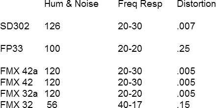

Is there more to grading the sound of a field mixer than these? This makes the FMX 32a look like a pretty good choice and the FMX 32 a bad choice. What's up with the Shure?
You can get a "GOOD" ENG/EFP mixer for 0.00-stats.jpg

I have 2x shure FP33 mixers and like them as a basic mixer, simple, reliable, and great for simple stuff,
still use mine for 'rugged' shoots rather than my SD442.
There are several shure FP33 mixers on eBay at the moment at VERY good prices, if you are interested get one with a porta brace bag / case.
The FP 33 is a bit better and robust than the FP 32 and 32A.
Brian P. Reynolds is offline   Reply With Quote

The 32a was advertised when it came out as a substantial improvement over the earlier 32 version.
I still have an M267 with the AC power cord removed that dates from the 1970's. At the very least it makes a great tone generator with mic/line switchable output levels.

"The 32a was advertised when it came out as a substantial improvement over the earlier 32 version."
-- Neither were very quiet, but dependable and the staple of ENG mixers in their day. It's near impossible to get parts for the 32a, but the original 32 used many generic components which are easy to obtain. I still have a 32 in my attic as well as a M67. The M67 wasn't exactly portable though., needed an external battery PS if A/C was not available. The M67 had it's day as well in broadcast studios.

The main problem with the FP32 was only 18v phantom power, the FP32A was upgraded to 48v phantom and the FP33 came out with better sealed pots and a better ganged master O/P gain control.
