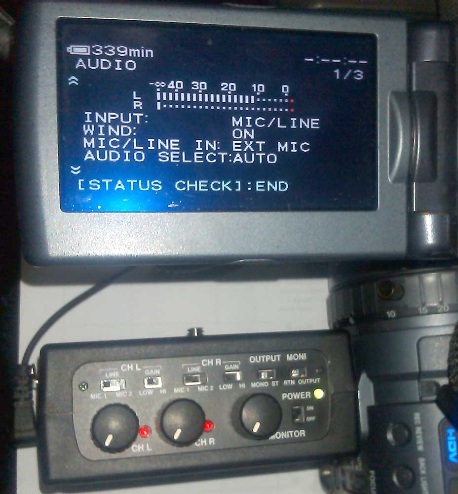

Hi there,
I just bought an Azden FMX-DSLR as portable mixer, output to audio mini jack.
Although it is designed for DSLR, I'm sure it will also fit to most small camcorders with mini jack inputs.
But, as I test, there is a 'hiss' on the left channel, even without any cables attached.
Settings:
CH L & R = Line: Mic 1
Gain = Low
Volume = 0
DC48V CH R & L = OFF
AGC = OFF
Output = ST
Moni = Output
As seen on attachments:
IMAG0444-web.jpg:
>On camera (here is Sony FX1 - tried also on VG20 - same result), there is constant signal like this.

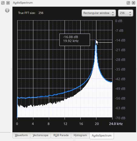

>As seen on Audio Spectrum graph in KDEnlive Linux video editor, a signal in 20 kHz.

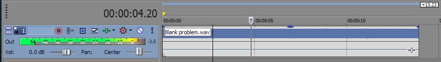

>A waveform preview as seen in Sony Vegas Pro.
Blank problem.wav.wav
>Audio sample as recorded.

Some hiss is normal for an unterminated input; input noise needs to be measured with the signal bridged to ground through an appropriate resistance in order to get an accurate indication. That being said, it is an Azden...
