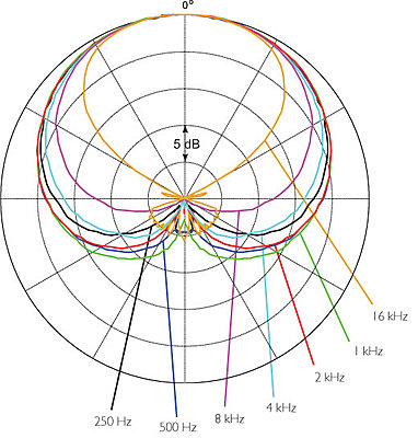

Consider the attached set of polar response curves.
Start with the black line, representing the pattern at 250 Hz. Note the shape of the curve.
Now compare the dark blue line (500 Hz) the green line (1 kHz) and the red line (2 kHz). Note that as you go up through those frequencies, you start to get a little bit more pickup behind the mic. Subtle, not a big problem for most applications.
But look what happens to the cyan line (4 kHz) purple line (8 kHz) and especially the yellow line (16 kHz). The sensitivity at the sides of the mic starts to fall off significantly, as you go up in frequency! So when you're off axis to this mic, the high frequencies will be diminished and the sound will start to sound rather dull.
That's why you want to use a single cardioid mic element, pointed directly at the sound source (i.e. the talent).
Having said all that, let's consider the AT 822. Based on your questions, I think you're assuming that the two mic elements are each pointed 90 degrees off the physical axis of the mic body. That's very unlikely. They are probably each about 45 degrees off the axis of the body, in other words 90 degrees apart from each other.
When you seemingly point the mic (body) directly at your talent, he's actually 45 degrees off axis for each of the two mic elements. If the elements in your mic had the same polar response as that published diagram, then each element would be about -9 dB at 16 kHz, and your audio would sound dull as a result! (However, the sample curve is not for the AT 822; and I don't have a good set of polar curves for that mic; it will be somewhat similar but also somewhat different from the sample curves.)
Now, as far as your two-person interview scenario: If you could position the mic so that each person was off to the side of the axis of the mic body by about 45 degrees, then yes, you would get fairly good pickup on the two people. But it still would not be a great track. Because person "A" would also pick up on mic element "B" but with very reduced high frequencies. (He would be 90 degrees off axis for the other mic element.) You would have poor isolation: each person would be on both tracks. And if you made a continuous mono mix of the two tracks, it would sound dull, because you'd be mixing two versions of each person: one version "flat" and the other person very muddy. The only way to produce a really good finished result would be to edit, cross-fading between mics as the two persons alternated speaking (always using the correct channel for the given person).
And your scenario with three persons on each side of a table... bad. Again, the mic elements are not 180 degrees apart, they are only about 90 degrees apart. So there's nowhere that you could place that mic, that would even begin to get everyone on axis of one element or the other.
Unfortunately, as you learn more about sound, you'll learn that it's not as easy as you initially thought!
Does this make sense? Does the color image of polar response curves help?

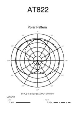

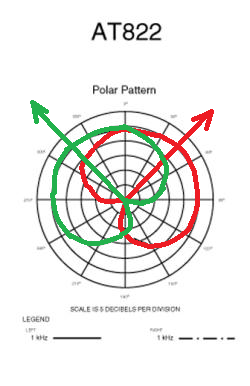

Here are two diagrams of the polar pattern of the AT822. One is the black/white original, and the other shows my crude attempt at highlighting the left cardioid pattern in green, and the right cardioid pattern in red.
As you can see from the arrows I have drawn, the cardioid patterns of the left and right capsules are each 45 degrees off-axis from the body of the microphone. This is a classic stereo microphone design. As we have said before, you actually have TWO cardioid microphones in a single body. Like a two-headed monster.
