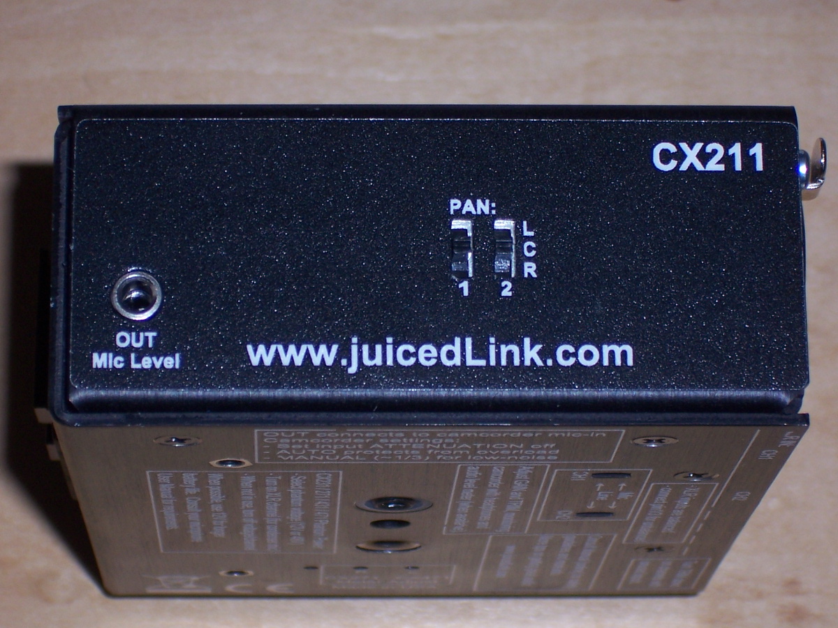

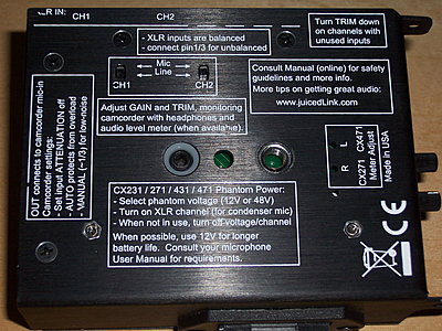

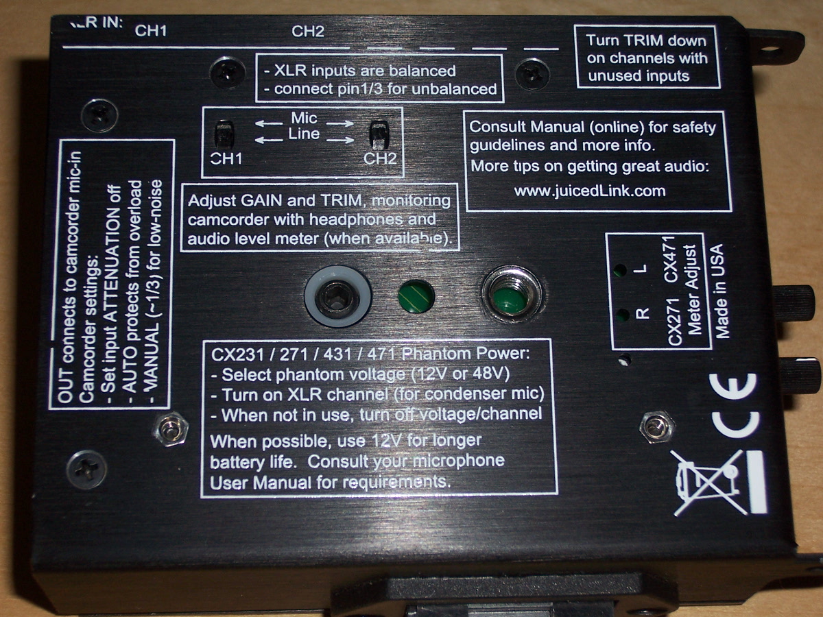

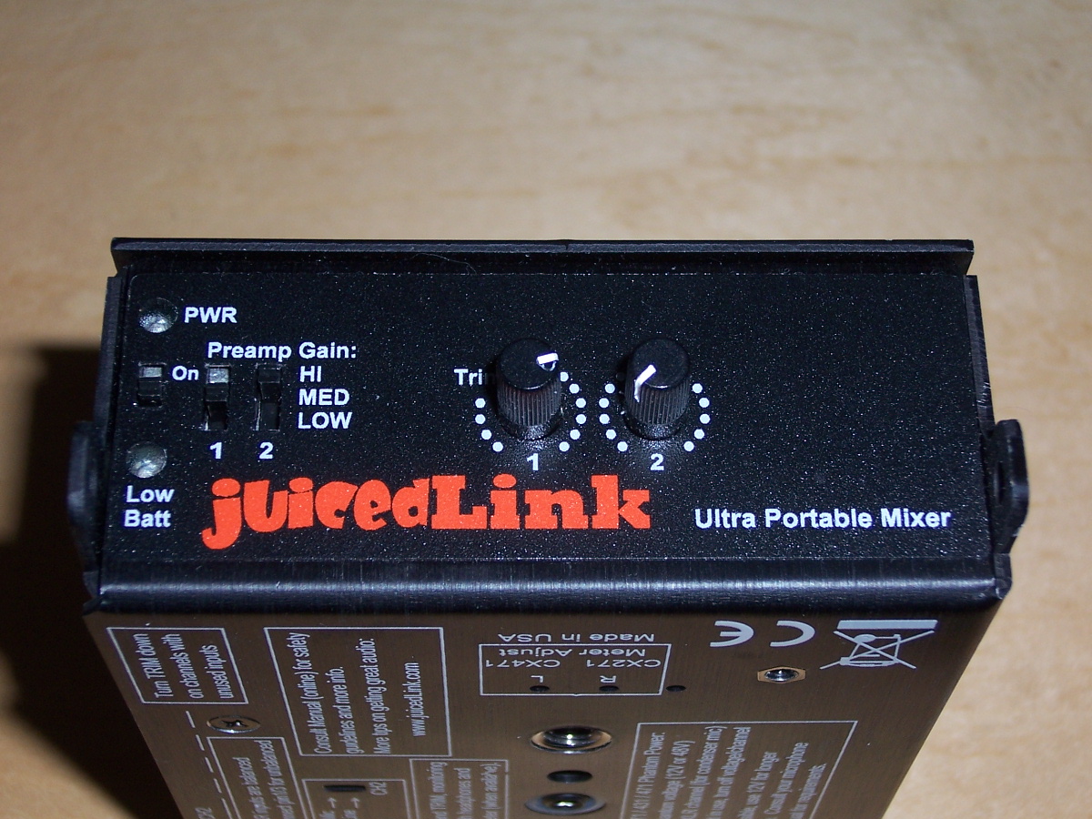

Presumably by using a preamp like the JuicedLink and routing the audio into your camera, it all gets recorded onto one audio track?
I don't know for sure, but I think that all the JuicedLinks are stereo or better (i.e., 4-channels). Mine is the cheapest model (now discontinued but they have come up with new accessories for it) and it has 2-channel capability.
Thanks to the switches and controls on the JuicedLink one can switch it over to one channel if you want, and there are, of course, separate gain controls for each channel. On my camera both channels are recorded onto a single audio track.

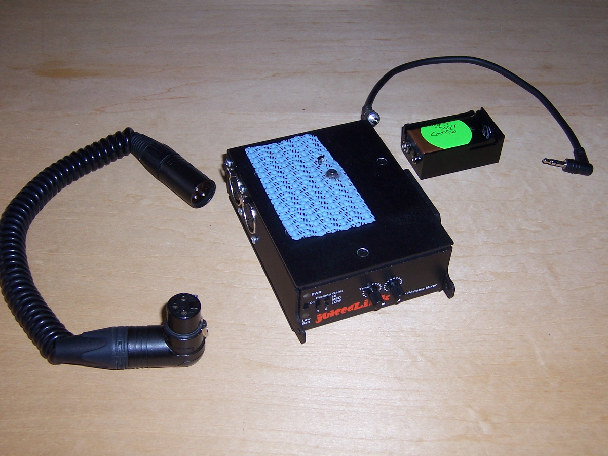

Cables: Right-angle cable ends are your friend. The straight-in ones are easier to break off or even ruin the jack they plug into.
XLR connections: Locking connectors are good because they don't accidentally come apart. The ones on the JuicedLink are locking.
I'm going to try and post a few pictures of the CX211 to show the jacks and switches. The patch of blue is some "anti-skid" material to help prevent the JuicedLink from turning (I hate the thought of over-tightening the screws and perhaps ruining something) and it also helps to protect the cosmetics on the bottom of the camera.
The first picture shows how my wiring is set up. the XLR comes from the mic. I've got some cables that run about 30 feet so there is flexibility. Neutrik is a good popular connector and they're made in Liechtenstein. Your trivia for the day. The 9V battery is shown removed. The 3.5mm 2-channel cable goes from the preamp output to the camera.
