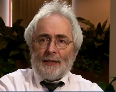

There seems to be a recurring question about how much a good mic placed on top your camera will improve your audio. The short answer is it will most likely improve it but it still will sound like crap. Here's a short video showing how much difference it can make.
Sanken CS-3e example - YouTube

The on-camera mic in the video really had a lot of echo. And I mean, a LOT. Can't say that I ever remember getting that much. For just ordinary family videos and the like I use a Rode Stereo Video Mic on the hot shoe because it's easy and fast to set up. So far, I haven't noticed THAT much difference but maybe I've been lucky.
If there's any consolation, at least the audio from the on-board SVM is better than the built-in camera mic.
It would be interesting to hear what innovative solutions there are for one-man shows. Using a light stand with a boom that was posted earlier is a good idea. Lavaliers are an option. Hidden mic with a cable (but not practical for most family-type gatherings). At this point I'm running out of ideas.
Last edited by John Nantz; January 24th, 2013 at 10:13 PM. Reason: changed on-board camera mic to built-in camera mic

That particular room was super live. Yes, it did have that much echo. No matter what mic you used on camera there would be that much echo. We actually had three cameras running and the other on camera mic had the same amount of echo.
For this interview we did boom in the mic on a light stand that had a boom arm. It allowed us to place it without having a shadow.
