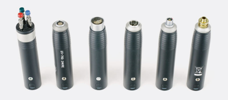

Canford Audio also do a selection of affordable phantom to plug-in power adaptors.
