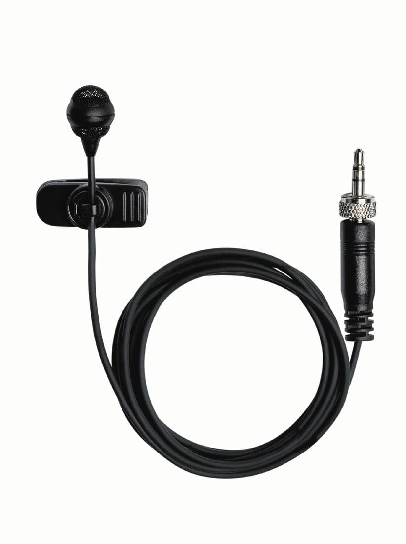

The 'ball shaped' mic pictured is the cardioid ME4. Both are pieces of sh__ IMO. The ME4's clip is about the worst I've ever seen, even more useless than the mic itself.
One of systems I purchased mistakenly came with the ME4 instead of the ME2. I didn't plan to use the OEM mic anyway, so no-harm-no-foul.
Sorry - you are TOTALLY WRONG!
Please get your facts right before you post.
The ball-headed mic pictured is an ME 2 - the ME 4 is a larger ball and shaped slightly differently.
It is very obvious that the mic. pictured is an ME 2 as it has no rear entry slots for the cardioid pattern.
Round ME 2
ME 4
You can see the difference in the pictures above.
But I do agree with you about the clip supplied with the round ME 2 and the ME 4.
But these microphones were designed down to a price to keep the kits affordable - the MKE 2, supplied with the more expensive sets, is vastly superior.

Re: Microphonics - ME2 and AT899
If you say so John.
But the one pictured appears identical to the one that was sent to me ans specifically states, ME4 cardioid.
If you say so John.
I'm well aware of the superior MKE series mics.
Cheers, Rick
The original picture was *definitely* a round ME2.
It's easy to tell the difference - the ME2 is sealed on the rear and the ME4 is larger and has mesh on the rear to allow the rear entry to get a cardioid mic.
(I did work for Sennheiser UK for 25 years, so I *do* know the difference) ;-)
I stand corrected. Thanks for the clarification.
