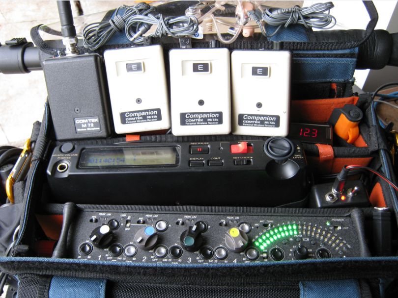

Here is the setup I use for Commercial productions / SNG- ENG jobs.
1x Comtek TX and 3x Comtek RX.... the TX can be fed from the direct outs of the 442 mixer or a feed from the TA3 sockets with the main mix O/P.
With SNG-ENG I will bring the return IFB into the mixer into (CH4) feed a 'direct out' of CH4 to the comtek TX, then will pan CH4 post fader to the R this gives me an XLR o/p of the incoming IFB signal than then can be fed to a cable IFB user (portaprompt) the 3x RX go to Talent, Producer and Camera operator. I can also monitor the incoming signal by selecting stereo in my headphones.... LEFT is outgoing signal, RIGHT is incoming.
