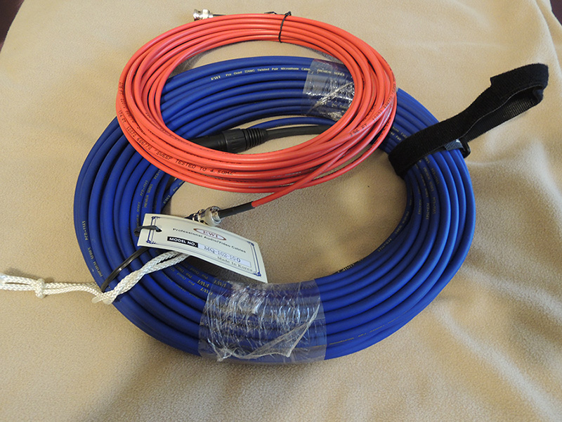

Jonathan,
I'm not sure where you do most of your work, but i do a lot of work in Convention centers and hotel ballrooms. And when the A/V guys come in to strike a show all cables look the same to them. And you can easily come up short a cable or 2. And i don't think anybody has ever taken my cable on purpose.
You might want to consider ordering colored cable, you can get it in bulk. I do that with my XLR's and my SDI cables.

Al,
Most of my work will probably be one on one or two interview type things, but I agree with you that having different color cables would make things easier to keep track of especially if you have more than one mic working. It would sure make things obvious when plugged into a mixer.
I also put little white tape labels on the ends of my current cables, 6, 10, 15, 25, etc designating the length so that there is no guessing there. I then store each cable in it's own freezer zip-lock bag, keeps things nice and tidy.

Seeing those long cables coiled up makes me wonder how you all store your cables? I climbed up until eight years ago, and now store all my long cables the same way as my climbing ropes. Never a tangle, never any problems at all in fact. No twists which can kink and shape the cables over time. And it is also quick and easy.

Trevor,
That was interesting. But video and audio cable is best wrapped with a industry standard method called "over under"

Al,
That's an excellent suggestion about colored cables. I completely forgot to mention that. At one time I found a nice medium-dark purple color, which was quite unobtrusive on a podium or stand mic. Yet when the time came to strike, nobody was going to pick up one of those by mistake... clearly purple when you had it in your hands.
And also an excellent suggestion about over/under wrapping. I learned it years ago as a stagehand, where it was frequently called "west coast" wrap. It's quite amazing that you can coil more than 100 feet of heavy mic snake into a road crate, then pull it out again without any kinks or snags. And any wire (not just mic cables) will last much longer when wrapped this way. Definitely a valuable skill to learn, because you're wrapping cables every day, whereas you're soldering just occasionally.
Both are valuable advice to any beginner, or even any old hands who missed them along the way.
